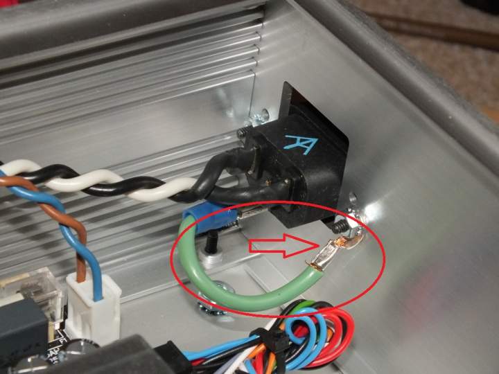

Ok, for some reason this: "connecting the chassis to the safety earth terminal of the power line. I did not say ground, though ultimately this is connected to the physical ground/earth near the panel where the power enters your premises" sounded pretty involved.
 If it's just making a connection to the chassis, that can't be too difficult then. I've built crossovers from scratch, hopefully that's enough experience to do this. I'd like to buy an inexpensive, plain box I can drill into and mangle, so I can learn it, and then get some nicer monoblock cases later. Unless monoblocking in seperate enclosures makes no difference.
This is what Mike added.... see the RED circle with the RED arrow.  The green wire, that's the ground wire.
What he didn't show was that after you do this you need to check and make certain that you have continuity between the ground lug on the IEC and the chassis.  Adding the wire is great but it doesn't work if there's paint or anodize.  Be sure to clean it off and use a DMM!!!  His chassis is obviously bare aluminum.
Good point. The chassis is actually clear anodized. I use a counter bore style drill bit, by hand, to remove the anodize around the holes. This was done for the XLR ground, the noise post of the SMPS and of course the IEC where the safety is connected.
