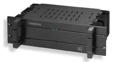

SGK
  • Posts: 87
Re: Hypex NCore question and answers
« Reply #738 on: 21 Aug 2013, 04:36 pm »
Hmmm... this could be a fun project even for a novice like myself.  I have a Bryston 3B that's sat in storage for about 13 years.  I wonder if it would be a good enclosure to work with.
jtwrace
  • Posts: 11432
    • TIPP YouTube Channel
« Reply #739 on: 21 Aug 2013, 05:12 pm »
Yes but a bit large for what it needs to be.  Also, I'm sure there is some Bryston fan out there that would love to get his/her hands on that unit that's been sitting for 13yrs.
