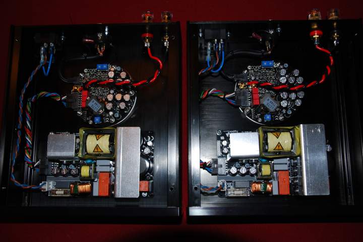

Hello,
I finally built my Ncores with HtCoz's dual mono chassis.  My experience, however mirrors this person's post on DIYAudio with link: http://www.diyaudio.com/forums/vendors-bazaar/190434-hypex-ncore-461.html
/begin quote:
Having an issue with a pair of Ncore modules I am building for a friend.
There's no bass. It's almost as if there's a 6dB high pass filter above 100hz. The gain on the amp is also fairly low. With high sensitivity speakers I have to turn the volume fairly high to get it to a normal listening levels.
A few notes:
1. I designed linear power supplies for the modules.
2. The issue happens with both SMPS and Linear PS. The distortion on the top end is worse with the SMPS, but the bass reproduction faces the same issue.
3. The unit is wired for balanced operation, but I am using an RCA to XLR cable wired per the datasheet.
4. The speakers I'm using have a very high QTS of .95 and are full-range crossoverless (I think I read some comments somewhere about this).
5. The amplifier plays 'music' and LEDs light up as they should.
6. The issue is the same in both channels.
7. No crackles, pops, clicks, hums, or noise
/end quote
Except for the following - I have the default SMPS 600 power supplies and have the Gedlee Abbey 12A speakers.  I heard Jason's Ncores through the tour and mine sound nowhere near it.  Mine is bright and the output is low.  The amp works as it should with all the lights on and no hum or hiss.  Any help is appreciated.  :cry:
Christian
PS - I'm also using the same preamp I used during the tour - the superphon passive pre.

I checked the connections again and they're pretty snug.  The connections are also twisted with tie wraps, except for the speaker wires because it doesn't need to be.  I remember when I had your amp, Jason, the superphon preamp would be at about 9 or 10 o'clock position and it would be pretty loud on the Abbeys.  Now I have it at 1 o'clock and it's only the highs that are loud.  And I have to tone the sub (I have 3, but currently have 1 connected) because it's too loud.

rave959,
Is there any possibility the speaker binding posts are touching the metal of the chassis and creating a partial short? This would cause problems like you are having.
Some close up photos of the input and other wiring might help us. Hard to imagine both amps having the same defect.

Hi Mike,
Here are some photos:
The case is anodized.  Also, the WBT-like binding posts have some sort of "inner sleeve" tube to prevent contact.
Thank you,
- Christian

This probably won't make much of a difference but...make sure on the right side of your enclosure that you redress your output wiring so it doesn't float right over the output inductor. I take it that you have checked and rechecked that continuity is excellent between the designated areas that need to have continuity! I would double check for shorts even with an anodized case as Mike suggests.
The audio input is differential. This means that ground is not part of the audio signal. When
connecting an unbalanced source, treat pins 1 and 2 as a floating input with pin 2 being the “audio
ground” of the source. Pin 4 may be used to attach the shield of a shielded twisted pair cable, but the
“audio ground” connection of an unbalanced source should never connect here.
On J9, make sure you are carefully following the Pin number designations (as stated in Figure 11.2) and how they connect to the XLR pins. Figure 2 on page 12 can be a bit confusing.
Remember Pin 1 on J9 is the non-inverting audio input (+) which connects with Pin 2 on the XLR; Pin 2 on J9 is the inverting audio input (-) which connects with Pin 3 on the XLR and Pin 4 on J9 connects to your chassis.

Picture is not sufficiently clear for me to see the XLR connectors: which cable is connected to pin 1? It should be the shield cable (and not the inverted signal of the clear cable). A just mentioned in the previous mail figure 2 on page 12 is somewhat ambiguous.
When I prepared my connectors waiting for the ncore and needed quite some time to find a coherent explanation for the J9 to XLR connections in a fully balanced mode without special switch-on button:
Documentation says: (colors of cables are those mentionned on dyaudio, but I would not like to rely on cable color solely)
Connector J9 -------------------------------------- xlr connector
Pin1: audio signal (red) ----------------------------> Pin 2
Pin2: inverted signal (clear) ------------------------> Pin 3
Pin3: nAmpon (black) ------------------------------>| Pin 1
Pin4: shield/signal ground (yellow) -----------------> | Pin 1
Unfortunately the placement/numbering of pins on J9 (Section 11.2) is ambiguous on figure 2. Example, pin 1 on J9 (bottom right when looking front) should be connected to audio signal, but when I looked first at figure 2, for me bottom/right is the one in which the blue wire is connected, which is inverted audio as it goes to xlr-pin3.
I think the reason of my misunderstanding is that I interprete the connector as being visually bended (2 and 1 near to the border and 4 and 3 on top being pushed to the right to see them as on a Picasso painting), so I read
2 4
1 3
whereas Bruno sees it probably as on the map for pin connectors (while the plate below is turned differently) so he reads
4 3
2 1
this seem to be coherent with the connections on Figure 2.
