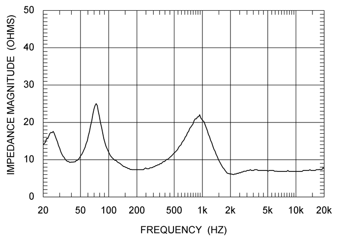

On a scale of 1 - 10, how SET friendly would you say the above is?

The impedance peak at the XO is almost as high as at resonance. With a SET you will have a peak at 1k. IMO not a great impedance curve for a SET. The rise at resonance should extend the bass (but care, it may also get "fat").

Thanks, Dave. The bass actually sounds pretty tight and detailed. But I suspect the peak around 900 is taxing the 8 watt power output. In addition to that, I just found out the manufacturer has overstated the sensitivity by about 3 db according to the measurements taken at the NRC. So the speakers I thought were 89 db @ 1 watt are really 86 db...  I should have known better, oh well.  :oops:
