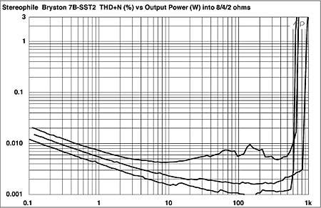

Very good summary Josh. The importance of a benign impedance curve is often misunderstood
The graph may be pretty, but it has been clearly shown that it has NO correlation to sonics and is pretty much meaningless. One has to go back a step and see the data before it was collaped to get any idea.
Do note that the rise at the bottom in a noise + THD chart like this is the noise becoming a greater proportion of the signal as the signal level drops.
