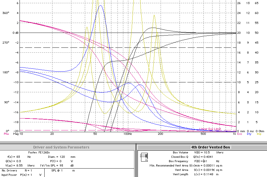

« Reply #26 on: 10 Apr 2012, 07:09 pm »
These Tekton 4.5 bookshelf speakers are 93dbs
If they are 93 dB, then they have to be using an FE126e or FE126En... that driver in a BR that large (similar to factory design, the design the comment was aimed at) has been described, to quote "as a cruel joke". Response (bottom curve) starts falling below 200 Hz,and any EQ to bring the bass level runs into the samll xMax of the driver. FE126 really needs to be in a horn if you want any bass.

Not my quote (althou i agree) and not about Eric's but the similar size factory box -- there is no tuning for that size box that gives reasonable bass.
