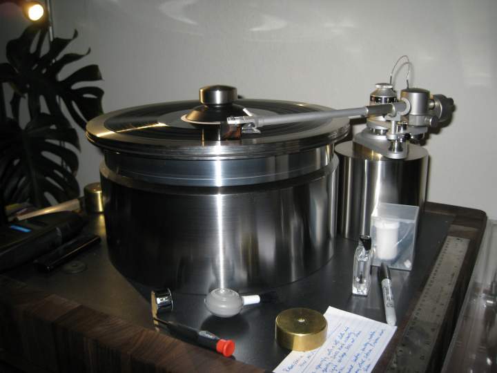

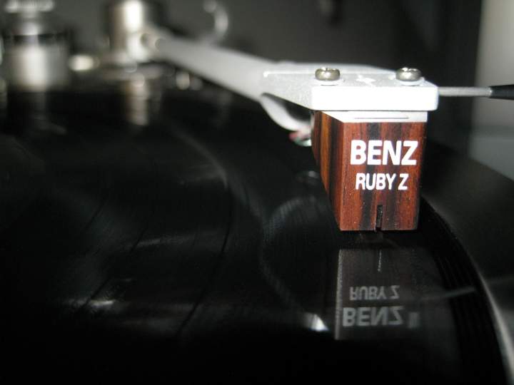

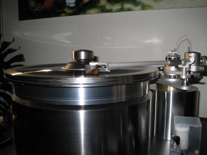

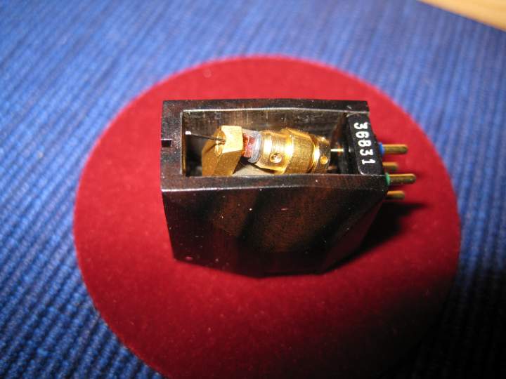

Time for a pic!

I don't know the answer BUT
1. Nice pics!
2. Is it making the noise with the cueing mechanism or by hand? Maybe you're acting like some kinda electromagnetic flux generation field capacitor (or something).
