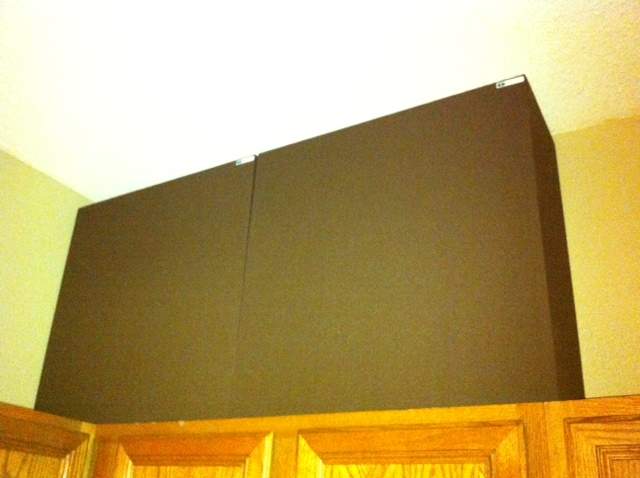

Thanks, Bryan.  My current situation has me with a really good listening room. The WAF is less of an issue right now. Not sure it will last forever but for now it's working out well.
The Scopus traps arrived yesterday evening and I was able to pick them up at FedEx (had them on hold) between work commitments; I had a Friday night event to attend for work so I didn't do much with them... :(
For now, I have them up in the rear wall corner side by side facing the front wall: please forgive the poor quality photo:
They are very solid with a nice fit/finish.  They match my other treatments. My impression is they would make excellent "stands" for either a full range absorption trap or for a diffusion panel.  They are 10" deep (these are the 40Hz models).
Initial sound: bass is less boomy and overall clarity/detail increased.  How much?  I don't know but I think they compliment the Soffit traps very well.  I will try to do some measurements this weekend.  No promises, right?   :lol:
