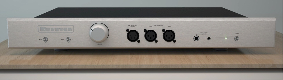

Re: BRYSTON BHA-1 HEADPHONE AMPLIFIER
« Reply #979 on: 19 Apr 2016, 01:00 am »
When did we loose the balance control ? :scratch:
Ouch !! - and I was hoping for a remote volume control, and a led on the pot ...  :nono:
