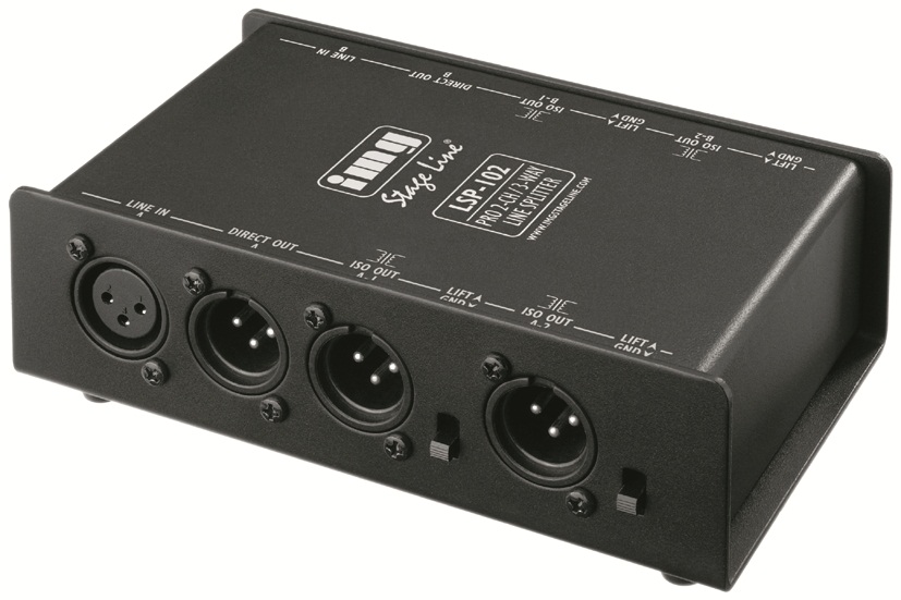

http://monacor.co.uk/products/prosound-mixermisc/vnr/251680/

Great input, let's compare those with the Goldpoint ones: http://www.goldpt.com/sw2x.html
Goldpoints are a bit more costly, for that at least you get stereo channels.... :D

a simple cable-splitter http://www.tbl-audio.nl/cables/index.php?item=xlr-y-kabel-_-splitter-_1x-female--_-2x-male_-zwart&action=article&group_id=27&aid=212&lang=NL or http://www.thomann.de/nl/cae_90074_yaudiosplittkabel.htm
a hefty input switcher Goldpoint http://www.goldpt.com/sw2x.html
the cheaper Monacor's http://monacor.co.uk/products/prosound-mixermisc/vnr/251680/
or the transformer isolated mic splitters, in line level version
http://whirlwindusa.com/catalog/snakes-splitters-and-multiwiring-systems/splitters/sp1x2-and-sp1x3-mic-splitters
if only Bryston had made a second balance out or a balanced passthrough ..... we could have integrated the BHA1 in our balanced systems easily  :?
anyhow, this is an interesting read on why and how to use splitters: http://whirlwindusa.com/support/tech-articles/microphone-splitters/

Hi Paul,
Am considering the option of the new version2 set......
Please let us know what your findings are with the Monacor, i ordered the 2 tbl splitter cables to test. Hope to compare them soon. Got this nice test scheme setup, cause on the bp26 I've found out that playing the BCD1 over a balanced direct connection, or over a balanced connection over the BDa1 to the BP26, there's no volume/soundquality  difference what so ever. Turning the source selector from bal1 to bal2 in fact leads to no audible difference. If these two new splitter cables hold up to that, i'd be happily surprised. Anyhow, a good and safe reference it will be.
Will let you all know.
Marius
Marius, you missed one option out, Buying another BDP-1/BDA-1 combo solely for the BHA-1 :wink: All of a sudden all the other options seem pretty cost effective :)
You are right though, it really shouldn't be this hard to have a 100% Bryston balanced system, especially as there really is only one source to consider.
I think I'm more tempted by a switching box rather that the cable splitter to be honest, my customer has gone for the Monacor solution but he has specified gold pins making the total £100 so I'm waiting to get some feedback but that does seem like the safest solution.
