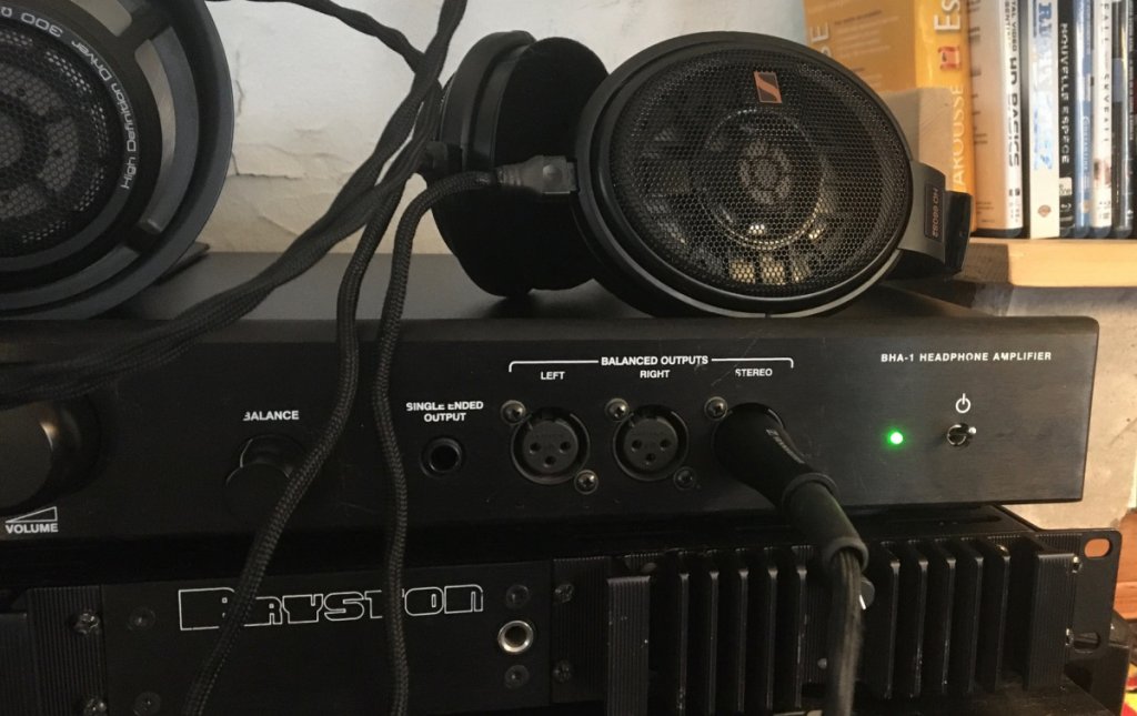

I wanted an SE output (RCA) to feed my tube amp, Schiit Folksvangr. Unfortunately, BHA-1 doesn't have one. May I plug a 1/4 inch to RCA Y cable to the front headphone jack to achieve this? Any negative impact to safety and sound quality?
rob80b
Re: BRYSTON BHA-1 HEADPHONE AMPLIFIER
« Reply #1368 on: 27 Sep 2023, 08:03 pm »
May be a mismatch, you are better off using a pair of Female XLR to RCA cables. (unless of course you have one of the first BHA1 without the pre-outs)

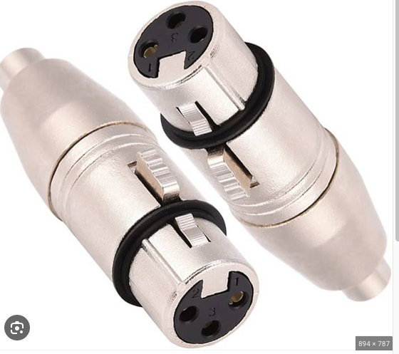

https://www.amazon.ca/Monoprice-104783-1-5-Feet-Premier-Female/dp/B001UNISK0/
To my knowledge, it is safe to go from RCA outputs to xlr input using that kind of cable, but it may damage your device if you go the reverse way. I think XLR outputs have higher voltage that may damage device with SE inputs. Is that true?
rob80b
« Reply #1370 on: 28 Sep 2023, 04:13 pm »
Balanced has a different wiring scheme, +, -, and ground, so yes is it very important when converting either way to use just the + and ground. The Monoprice cables that I've used do this correctly, not all do and things can get toasty.
And yes balanced has normally double the output, not always but that is not what will cause problems, it's incorrectly combining the + and - creating a possible short. Sadly some RCA to XLR adapter do this. : (
Melting735
  • Posts: 13
« Reply #1371 on: 28 Sep 2023, 11:13 pm »
Got you. Thanks a lot!

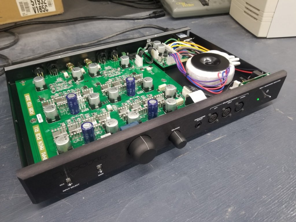

I had bha-1 for a couple of weeks. I really love it and want to keep it. It is an earlier version from 2014. I'm curious if there were any changes under the hood in those newer units that may affect SQ? I saw a couple of very new units popped out on market, but I wouldn't bother if there was no change :)
James Tanner
  • Posts: 20991
  • The Demo is Everything!
    • http://www.bryston.com
« Reply #1373 on: 21 Oct 2023, 05:53 pm »
Only change was after SN 50 we went with a balanced pair of output XLRs on the rear so you could use it as a preamp.

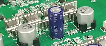

« Reply #1374 on: 12 Nov 2023, 04:30 pm »
Hi James...
Over in the Head-fi forum someone was curious about......
"But for what is the single blue electrolytic cap at each of the four power stages? Cap in series to output?"
Thanks Robert
« Reply #1375 on: 12 Nov 2023, 04:42 pm »
Hi Robert - email Mike on that - [email protected]
