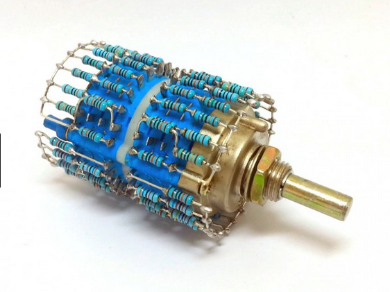

Think of an in line attenuator  as a fixed  single "stepped attenuator" using stepped resistors, they're  highly coveted but expensive but are way more precise and less prone to failure than a variable potentiometer.
So yes it would be better IMHO to have at least one of the components fully open, in this case the 2B and use the -15 attenuator to reduce its input as I explained earlier.
Both the BHA-1 and 2B are fairly robust and will handle almost any input, if I'm not mistaken.

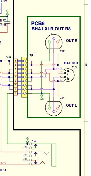

The BHA-1 schematics may help
http://www.bryston.com/PDF/Schematics/BHA1_SCHEMATICS.pdf

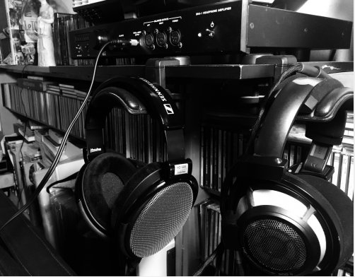

To see a picture of Grade PS2000e & BHA-1, I have the PS-1000e re wired with balanced ions 3 tips per channel.

Is there any advantage to a separate L/R balanced in vs the stereo balanced in?
rob80b
Re: BRYSTON BHA-1 HEADPHONE AMPLIFIER
« Reply #1155 on: 17 Jul 2018, 02:14 pm »
With the BHA-1...none what so ever.
http://bryston.com/PDF/Schematics/BHA1_SCHEMATICS.pdf

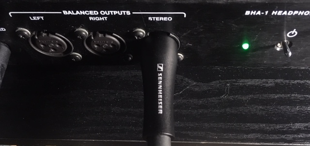

Sorry, I meant separate L/R balanced output vs single/stereo balanced output.
