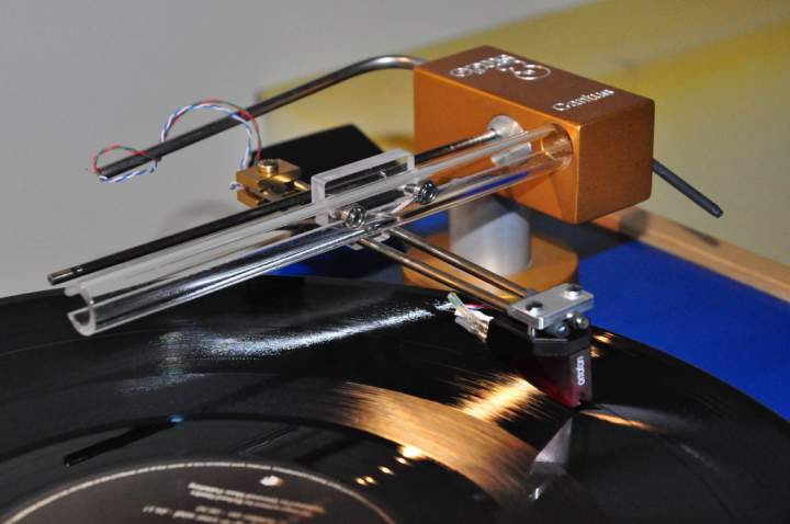

the l/t arm looks like an opus3 cantus by rauna.  retailing for <$800, i have always been intrigued, but i see no way of being able to use one w/a tonearm auto-lifter that i refuse to be without.

I have a Jelco Arm on one Ariston and a Rauna Opus Cantus 3 arm
 on the other Ariston. I have tried different linear arms from Clearaudio , Eminent and a DIY one on the Ariston , but not one worked satisfiable. Most linear tracking arms where too heavy on the Ariston where the spring loaded platter was shifting when the arm was moving on the table especially the ones with air supply. I found this Opus Cantus arm 3 years ago and it worked great on my Ariston because it is so simple and lightweight . There are not many Cantus arms available and sadly Bo Hansson the inventor from this great and totally underrated arm passed away a year ago .

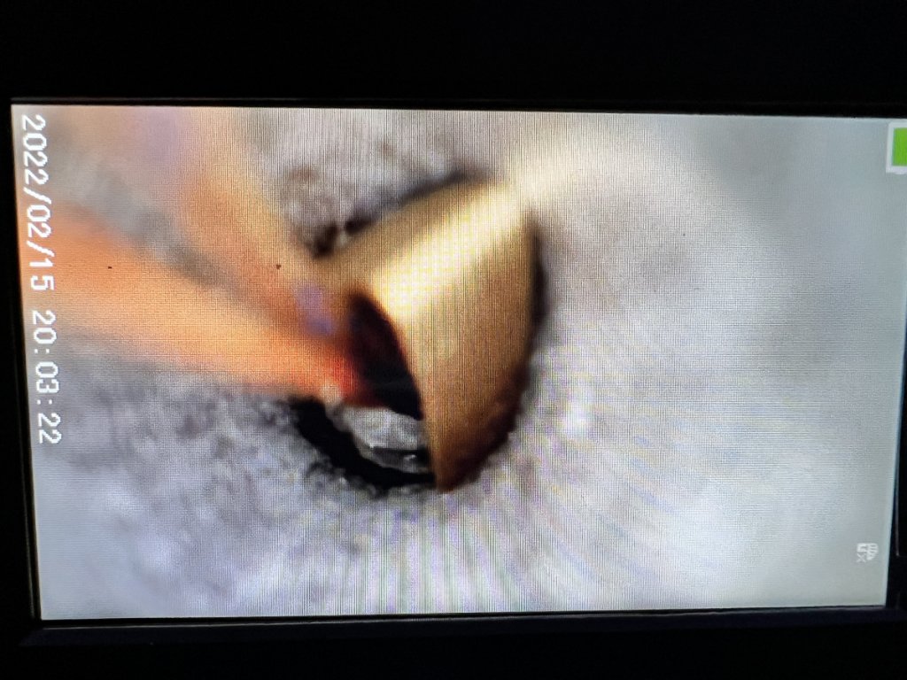

« Reply #23 on: 27 Apr 2023, 02:34 am »
I know this topic is 10+ years old but I been looking around an so far this is the only place I think I'll find the info I need. I'm trying to rewire the RD40 enigma tonearm but the wires won't come out. something is holding inside the pipe.
