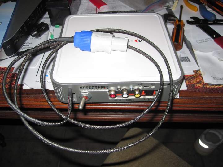

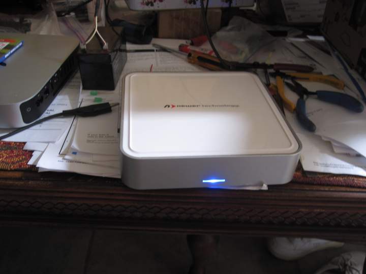

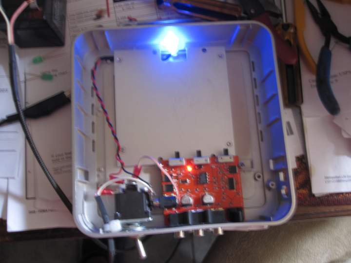

The case was a broken external IDE case I got from AC member.
Recycle  :thumb:

I'm sorry, I meant a 9V battery without the battery regulator or charging circuits in place. You have your switches set for an external supply. Well, I'm not sure what difference it makes in practice.

I preferred using both 9v battery as buffer and an external supply. Did not try 12v battery for external though.

Has anyone tried different output caps? (And/or would anyone happen to know what type of caps are on the board?)
wushuliu
  • Posts: 3766
Re: Miniature TDA1543 DAC Brings the Goods
« Reply #57 on: 8 Aug 2012, 04:27 pm »
I removed them and did not replace them since the receiver/pre blocks the dc. I think those are 47uf polymer caps on there. Not bad really to my ears.
