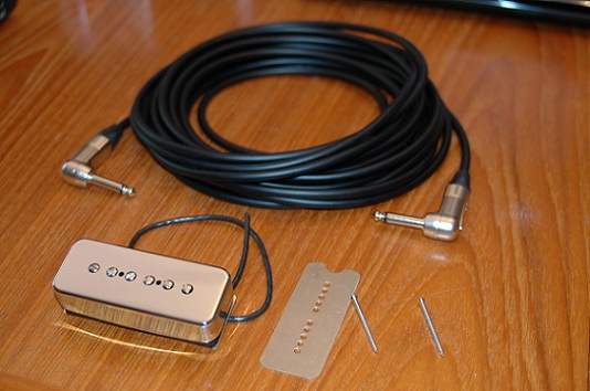

Here are the bridge pickup and new guitar cable for the setup.  Half way to the pickups needed.

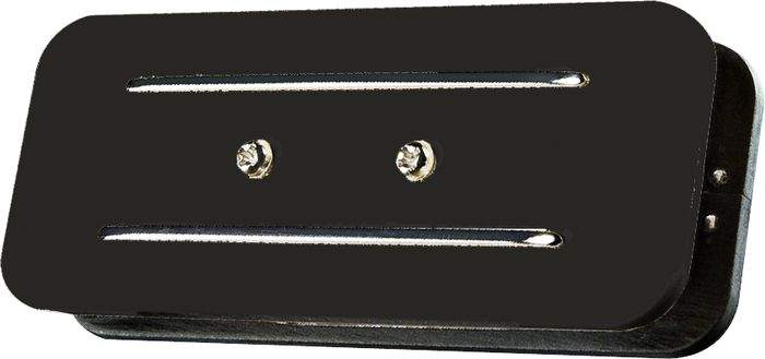

Found this while looking at new pickups.
This is a Joe Barden Engineering JBE P-90 soapbar.  Dual rail humbucker for a P-90 soapbar mount.

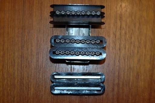

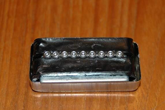

Since I cannot seem to order a John Birch style 9 Pole Simplux pickup, going to try and create something DIY to try for the SG Special neck position.  It is called a Sidewinder style humbucking pickup that sounds like a single pole pickup.  The design has been around since 1972 as far as I can find.  Here is a mockup of what it will look like inside the cover.
If this one works, will try building a 6 pole version for the bridge position so they are matching styles.  They are mini-humbucker size vs the P-90 size.
Waiting on a quote for Arnokrome 3 magnets for these.
Will see what happens!

Ok, some of the pickup parts to get some ideas arrived.  Here are mockups of three styles of pickups.  Might look familiar. :)

Paul,
I plan to make some new video's when I get the 9 pole HB working.  Will give some before and after comparisons if I am careful with the setup.

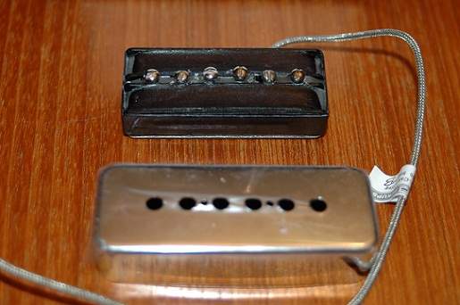

Ok, here is Lindy Fralin P90 hum cancelling bridge pickup.  Will compare this to the Seymour Duncan STK-P1 and see which one works well for C# tuning.  The SD is supposed to be similar in construction to the original 9 Pole Simplux.  The question is the magnetic pull on the strings when you are using a 9-42 gauge set tuned to C#.

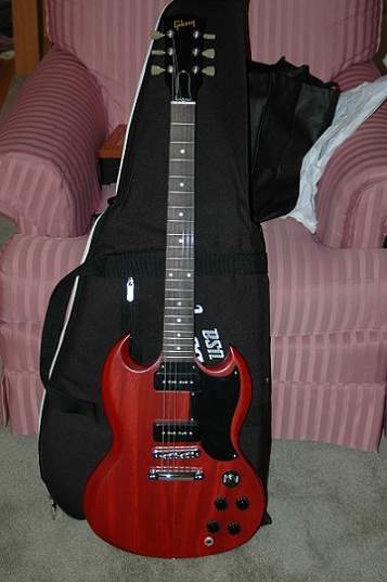

This one is getting a set of the Lindy Fraling P90 hum-cancelling pickups, along with other mods.  A person I know just built a new guitar for Tony.  When he gets done with my SG, it should look like a right handed version of this one:
