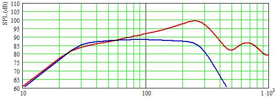

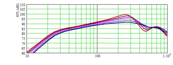

Really? I thought the depth dictated the upper 1/4 wavelength resonance, therefor shortening it pushed it up higher. I'm trying not to EQ, honestly right now its very listenable I'm just getting a bit picky and figured this modification would help the transition between drivers. What am I misunderstanding about the depth of an H frame?
This is a H frame without EQ. It starts with red and is cut down in depth until only the plain baffle is left (dark blue):
This is the same H frame as above (red). Then with the right passive EQ applied (blue):
It should be self-explaining ...

Ahhh hahhh... So I'm sorta right in thinking that trimming depth smooths the midbass hump, but I see it also loses efficiency on the low end as well. So I should prolly try maybe lowering the LP part of the x-over a bit to maintain the low end, but tame the upper hump? What your calling "passive EQ" looks like a crossover topology to me, am I right? Or should I be thinking a series notch/ parallel contour filter? Thanks again Rudolf, MJK, and others the graphs and your help are awesome!!
Yes, it is a crossover. In this case a passive 2nd order low pass at 100 Hz. You may have noticed how the passive filter helps to raise SPL around the Fs "knee" of the driver (30 Hz). Simply lowering the LP of your existing crossover will always lead to an exposed upper bass.
I don't understand why people refrain from "doing it right" when it could be as easy as adding a coil between amp and driver.  :?
