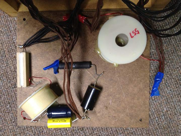

My newly built N3s have replaced a pair of the original Meadowlark Audio Kestrels.  I pulled the crossovers out of the Kestrels, and would like to upgrade the components therein with some nicer stuff (SoniCaps, Mills resistors, etc) from Danny, and use these speakers in a bedroom setup.
In the x-over circuit, there's a Bennic electrolytic 31 mfd capacitor wired in parallel with a 4.75 mfd cap (not sure the make), yielding a total capacitance of 35.75 mfd.  I'm a rookie at this, so bear with my possible ignorance, but can I simply find two SoniCaps that when their capacitance values are added, equal 35.75 mfd?  Is there a best practice for selecting values to get to this total?

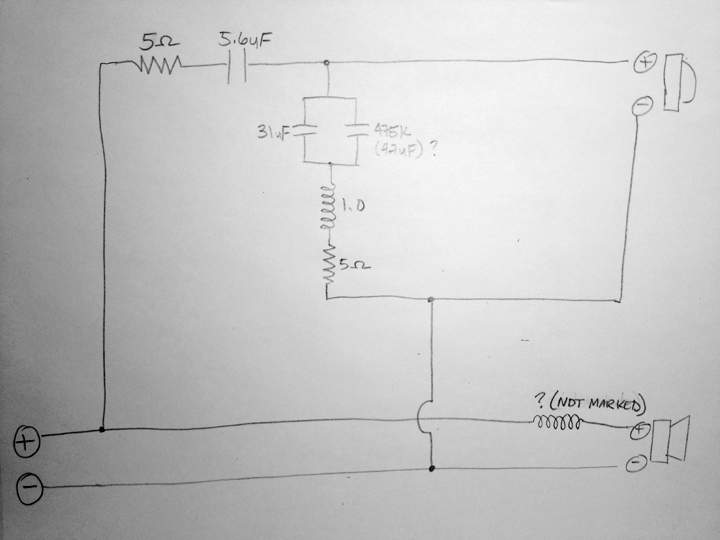

Thanks, Danny.  I've added a schematic which I think I've got correct, as well as a photo of the crossover in its present and original setup.  The yellow cap at the bottom is the one labelled 475K, which I've taken to be 4.7 uF.  Is that correct?  The blue one it's soldered to is the 31 uF Bennic.  If I remember correctly, the Kestrels are a 1st order, transmission line design.
Your guidance is always appreciated.

The 5 ohm resistor looks like it might be an older Mills resistor. If so it is good.
I'd replace the 5.6uF cap with a Sonicap. That is your only cap in line with the tweeter.
The LCR network is a notch filter and is all in shunt. So it is basically causes a short to ground. It passes no signal to the tweeter. So what you are looking for here is just no stored energy. And any phase shift from dissimilar values is of no concern in this position. I'd just replace the electrolytic cap with an inexpensive Erse poly and replace the sand cast resistor with an inexpensive Lynk resistor (60 cents) and call it good.
