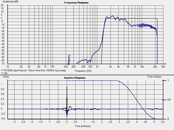

Finally, some progress...managed (after a lot of frustration) to do DAC/ADC calibration loop and make some new measurements. After spending whole afternoon trying to to do this calibration loop and measure again as per Nates advice, I'm now certain that mic preamp is mandatory - mic input on my laptop is just not good...
Anyway, new measurement of Beston RT002A dipol was made suspended at 134 cm height (precisely in the middle of my 268 cm high room, walls at similar or greater distance), mic on axis (at 134 cm also), impulse response (gating 4 ms), log syne sweep signal highpassed from 1500 Hz (to protect the driver which is connected directly to amp).
this impulse response looks inverted - is that normal? I checked, and connections are ok. Maybe my DIY mic is to blame?
And what about that FR? Looks weird, if anything, I would expect fallof at lower frequencies, not a hump...
Rudolf
Re: OB one and Hello everybody!
« Reply #44 on: 29 Feb 2012, 06:03 pm »
Give us some data of the Beston driver geometry (baffle height, width and depth, ribbon/membrane geometry and location on driver baffle etc.) and we could see in EDGE where the dipole peaks and notches are to be expected.
Rudolf
http://www.ribbonspeaker.com.tw/RT002A-980514.htm
104x104 mm, opening in the waveguide is 50x10 mm (I can't see how large membrane itself is).
Depth of the waveguide is approximately 15 mm.

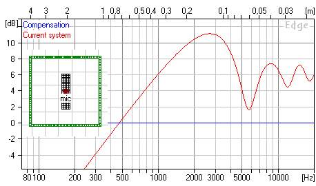

Haven't thought of modeling driver itself in Edge, great idea! Waveguide as small baffle, and opening in the waveguide as small driver...nice.
Rudolf
« Reply #46 on: 29 Feb 2012, 09:30 pm »
As suspected:
Dipole tweeters typically develop their first dipole peak around 2 kHz. It comes in handy as a 6 dB efficiency boost at the low end. But don't force such tweeters to perform well below that peak!
Cheers

Yes, and it correlates precisely with Beston recomended 2500 Hz crossover point...
How would you comment this simulated response in comparison with what I'm measuring?

« Reply #48 on: 2 Mar 2012, 02:26 pm »
gamgee,
some comments on your measuring methods:
1. Always measure from as near as the situation and the measurement target allows.
If you measure a single driver in its baffle, three times the baffle width should be sufficient as measuring distance. Even for a dipole, five times the width would be fully ok. If you measure your Beston from 134 cm, you either have to play it unreasonably loud or you are prone to fetching noise from outside.
2. Keep the measured object as far from room boundaries or other obstacles as possible.
You have done that already with your Beston measurement. While it is correct to gate your measurement to 130 cm, those 4 ms do limit your low end exactitude somewhat. By moving the mike nearer to the driver, the driver signal will become much louder in relation to the reflections or to noise, and you could safely open the gate to a longer window.
3. Don't see more in simulations than the simulation method allows  :wink:
Edge is safe for finding the frequency of the first dipole peak. Its simulated peak height is already questionable. Edge gives a faint idea of the following dipole notch - position only. Everything above that (in frequency as well as dB) is pure math with no relation to reality.

Does that mean I should measure naked drivers from different distances, according to their dimensions? For example, BG20 is 20 cm driver and RT002A is 10 cm - should I measure BG20 from 1m and RT002A from 50 cm distance? Nate told me to go for 1,5 m ...
Nate said: "I go about 1.5 meters to see what sort of dipole compensation I will need." He did not tell you to do exactly the same regardless of circumstances  :roll:
Best just try what happens when changing distances and angles. This will give you a feeling for what is enough and what not.
cheers
Rudolf
