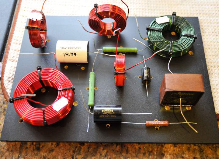

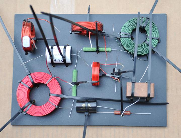

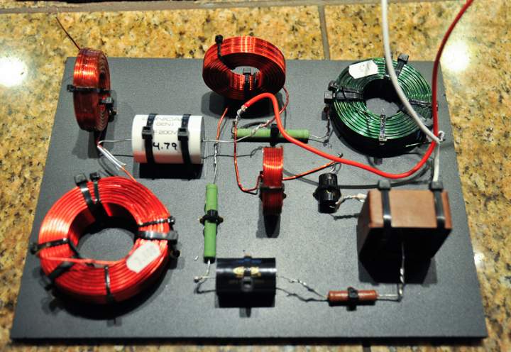

Yes, thanks Danny, and it's the pic I'm looking at but I'm really working from your layout you sent me with the kit. I won't post the layout but maybe it's a spacial problem in the pic that is confusing me.
It the pic, it looks like the big inductor 3.6mH is bottom right. It can't be though according to your diagram. That big inductor should never see the Jupiter cap and it shouldn't be in the woofer circuit anyway. So me thinks that the 3.6 is standing tall at the back facing us. It just looks small in the pic  :scratch:
The wiring diagram and the pic of the assembled crossover may not look at all the same. The diagram just shows the way it has to be connected and NOT the layout of the parts. Parts can be layed out completely different than the wiring diagram as far as placement. But they have to be connected as per the diagram.

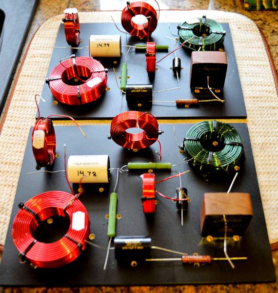

Progress made on the networks. See the last pic as a gut check as the wiring is coming together.
Side panels are getting color sanded. I continue to paint the rest.

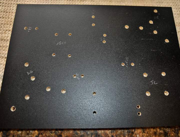

After the layout, I marked the holes and drilled

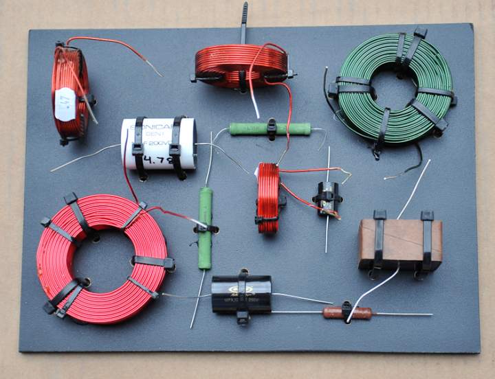

Now I glue the pieces down with a hot glue gun.
Next, tie wrap the parts!
OK, now we trim and here we are
Getting towards finishing the wiring on the first card. This look right ? :scratch:

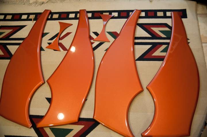

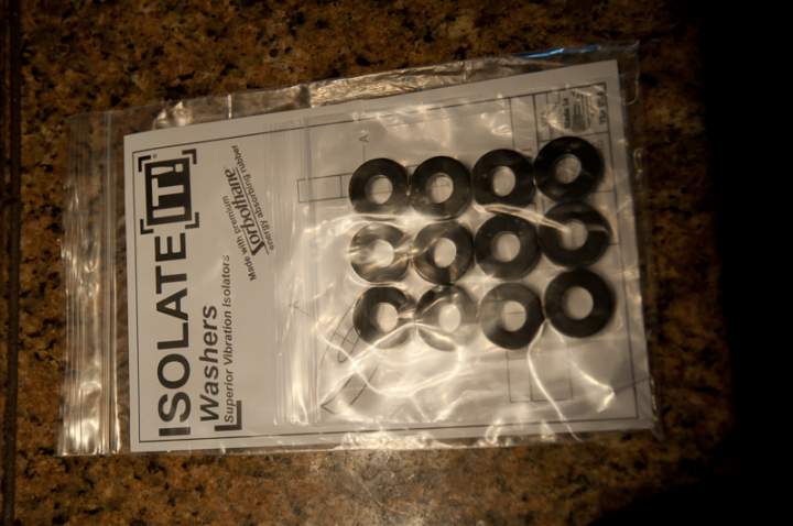

I picked up my side panels. What do you think?
I also received my sorbothane washers. These go between the crossover and the cabinet.
Danny Richie
Re: Super V ground up build - sharing the experience
« Reply #87 on: 17 Feb 2012, 02:49 am »
Wow!  :o  I love it!

MichaelHiFi
« Reply #90 on: 17 Feb 2012, 04:11 am »
They came out looking very nice. They match the room better that I could have imagined considering I picked the color at the body shop from a ring of color samples. Now we're scratching  :scratch: about the color of material for the speaker grills. It doesn't have to be black does it  :roll:
