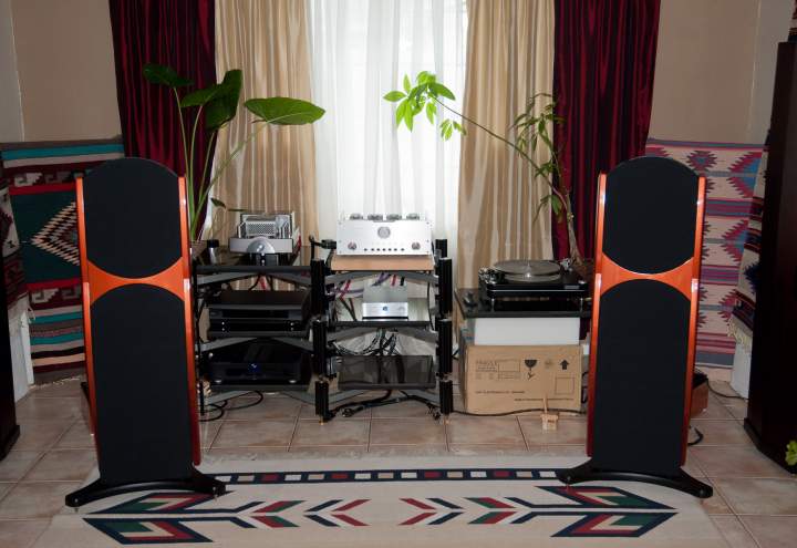

MichaelHiFi
Re: Super V ground up build - sharing the experience
« Reply #247 on: 17 Mar 2012, 03:13 am »
I'm going to build 2 extension cables for setup.  :thumb:

All dressed up and no one to share.
Soundstage I noted was skewed so I took a bias measurement and discovered that the settings were all over the place. I think I have 1 bad tube as I couldn't set the bias low enough. IO replaced the 6922 but didn't have a spare set of 12AX7's which I think is one of the culprits.
I'm really getting anxious to get my amp back. I'm also in a strange place with that amp. The owner's Dad passed so I've been patient regarding at least a phone call that never happened. It's been almost a month. Now I'm sitting here with an amp on order and a the same used burned up amp in limbo.  :?

I wish I would have known about the top driver gasket install and NOT have installed them.  :evil:
To pull them gaskets off will leave a mess and a very ugly looking driver. To leave them on pushes the grill away from the cabinet. Sucks. This will be on my lessons learned list.
