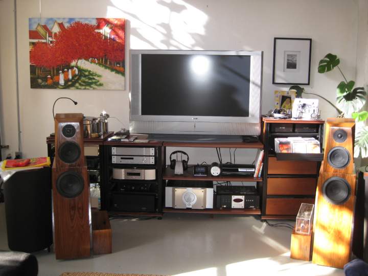

To answer some of Neobop's questions:
Are there footfalls that my cause issue?  No, the Salamander rack is on concrete floors
I can jump, drop a 100lbs on the floor and nothing would happen.
Is it top heavy?  Yes, about 200lbs on top of that Salamander Rack.
Is there a problem or do I just want to talk about it.  Well, just want to talk about it.  I haven't notice any issues as of yet.
How is PRAT?  Everything sounds very very good!  Like going from my suspended TNT to no suspended TNT and to this.  Everything is tighter, faster, blacker black, no noise...etc..
See pictures below:
TT on Salamander Synergy 30" rack
TT platform (1.5"MDF) surrounded by walnut butcher block and the brass cones underneath
Plinth/tonearm on MDF shelf....
Okay dokey, now we're getting somewhere, and your pics are on page 2 :thumb:
I'm trying to figure out where you could get some plasticlay in there. I think it would have to be around the outside of the platform. You could sculpt figures and stuff with the clay. If you're not good at sculpting maybe you can find a local sculptor or art student. That might damp the platform and help with the "knock on wood" stationary groove test.  :wink:
Is that the Classic platter or a steel TNT (if there is such a thing)?
Ever try a mat with it?
What cart?
Go straight into the Pass pre?
Tell us about your speakers. Scanspeak drivers w/series x-over?
About how many records do you have and what kind of music?
Who painted the pic above the table with the red bushes or trees?
Inquiring minds want to know.  :beer:

thanks Tom, but I don't have that platform to engage and disengage the VPI Rim Drive....I just move it to and fro...and it works.  The Rim Drive is sitting on it's rubber feet (stock).
What cart?
Plastically...well I can put it underneath the platform as there is about a 7.5" lip from the Walnut to the MDF...where the brass footers are attached...but that will have to be another day.  I just put this thing on last weekend..and with an 8 month old baby girl, I barely have time to write this email!
The Platter is from the VPI Classic the aluminum platter with periphery ring and stainless steel clamp.  No, haven't tried a mat with it...I've tried mats on the VPI Acrylic Platters but prefer this w/out a mat...but who knows.  I have two carts, a SS Retip Dynavector XX-1 LO and a Shelter 901.  The signal goes from the TT to the DIY Pass XONO Pre then via XLR goes to the X1 preamp and via XLR to the X250 amp.  The painting I got from Vietnam in 2006, in Saigon.
All cables are DIY, XLR and RCA cables, including Speaker cables!
DIY Pass XONO Phono Pre (used with the 901 at 100ohm) and Curcio Phono pre (used with the XX-1 at 479ohm load)
I'll get to the speakers another post, got to give my wife a break and get to baby Annabelle!

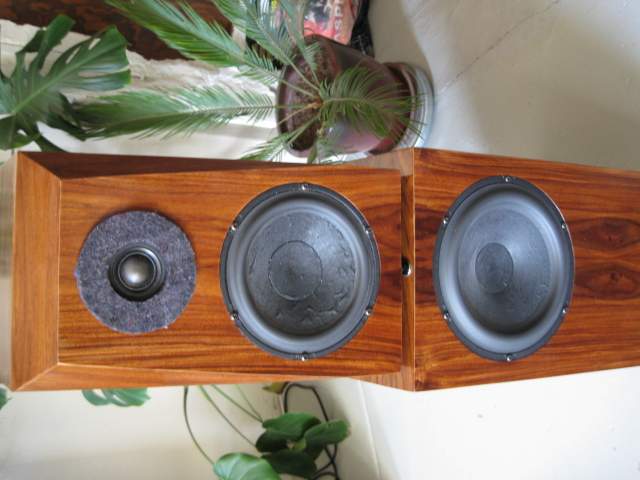

Here's a link to the speakers information.  http://www.speakerbuilding.com/content/1104/
