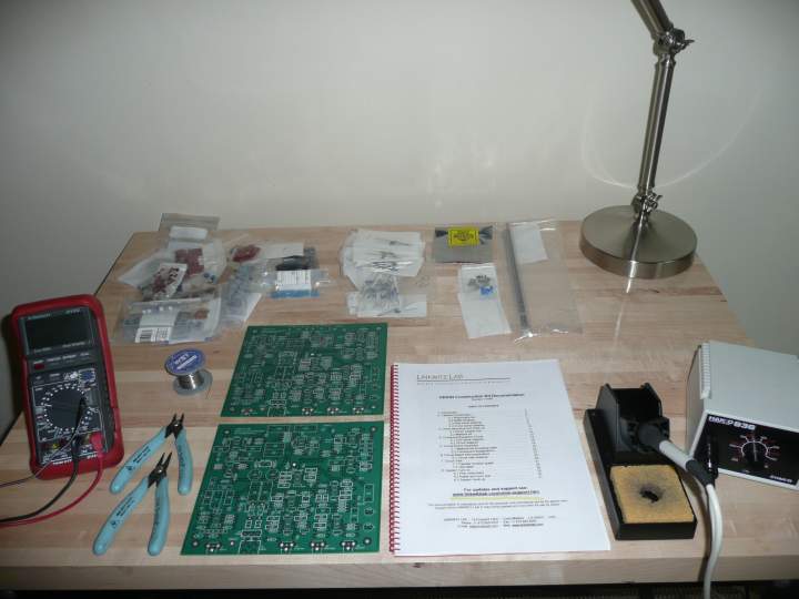

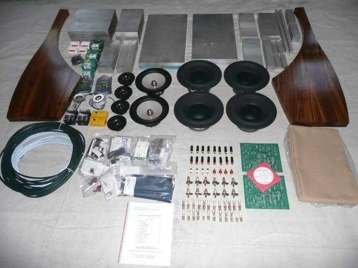

NOTE: I am doing the whole process myself but anodizing the aluminum.I never made kits but I did every thing myself.All I had for this was a construction plan,two blank circuit boards and a test CD.If the speakers were not active or would be offered as kit or finished then I do not think I woul be interested in. This one is getting build by 1" aluminum plate and will be 100% cocept and I tend to make very nice box for crossover also.

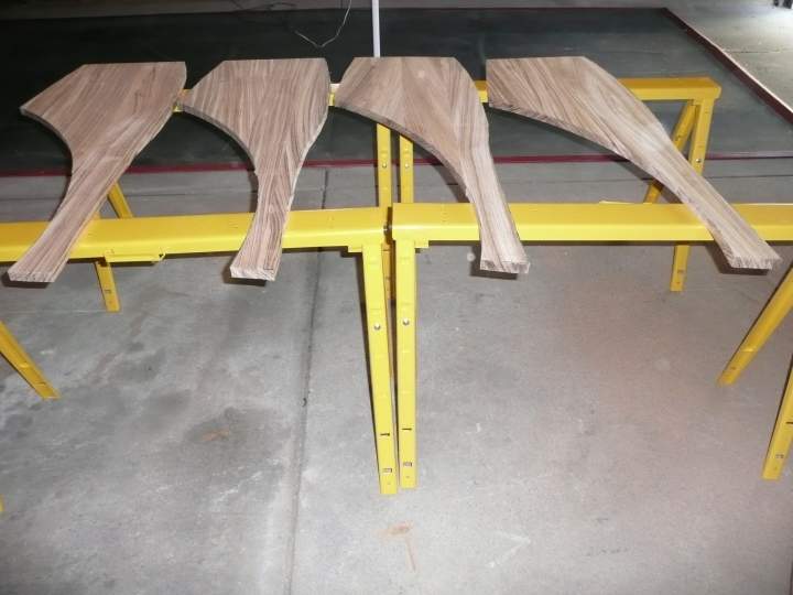

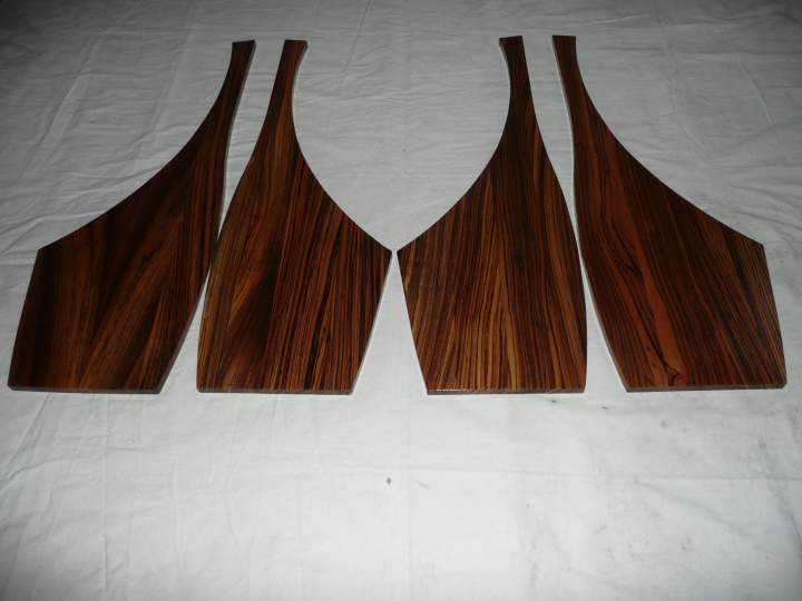

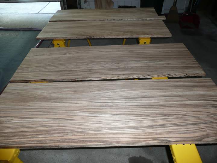

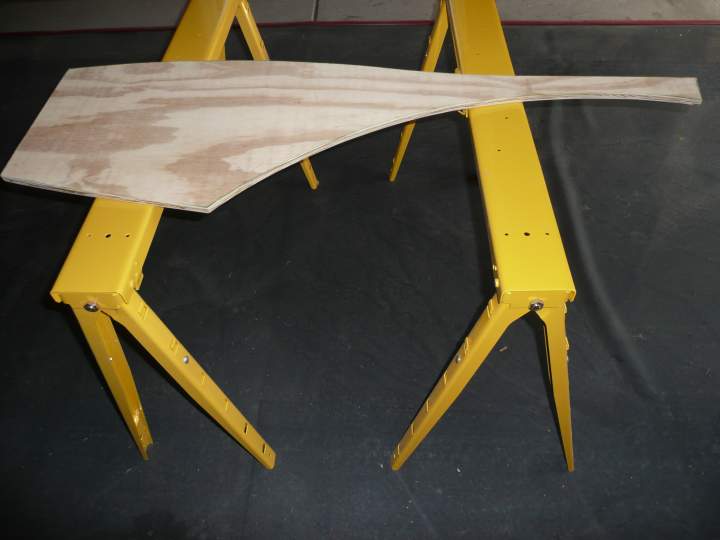

As you can see in the picture the side panels are done.I could get it done by CNC but it was fun and not hard to do at all plus the CNC was very busy.
My template came out very nice and needed no sanding at all just to smooth it out.
And the wood I am using is called ZEBRAWOOD.
http://www.ask.com/wiki/Zebrawood
Then I had a phone call and forgot to take a picture of the template I thought I did. :duh:
Well,it is too late now and this is the finished side panels which took me a month to finish it.I used the product called ARM-R-SEAL(GLOSS)each coat needs 24 hours to get dry and buffed by #0000 steel wool.Each panel has total of 8 coats to be looks like this.

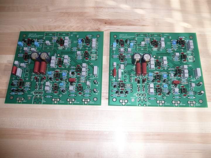

Last week I had some time over the week end to put the crossover together. The OP amps are not loaded yet and all the caps are 1 or 2%.

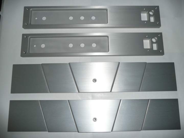

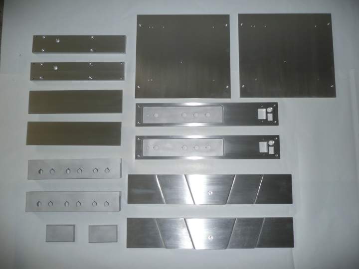

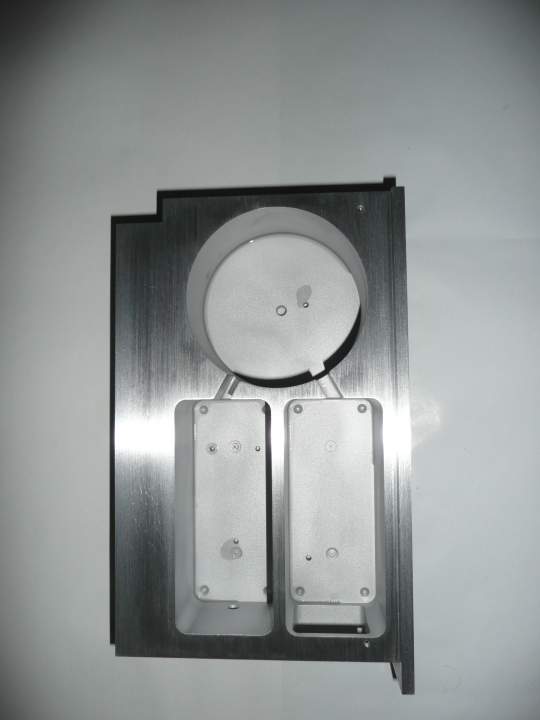

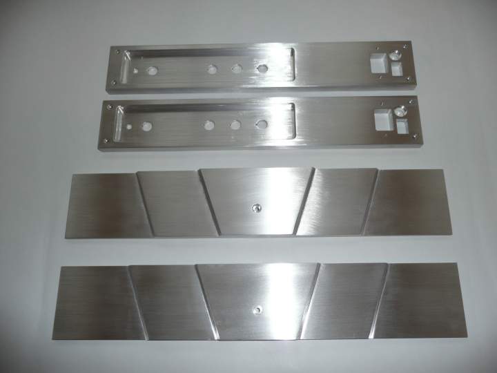

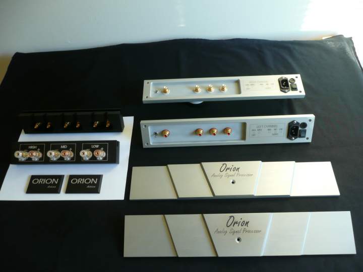

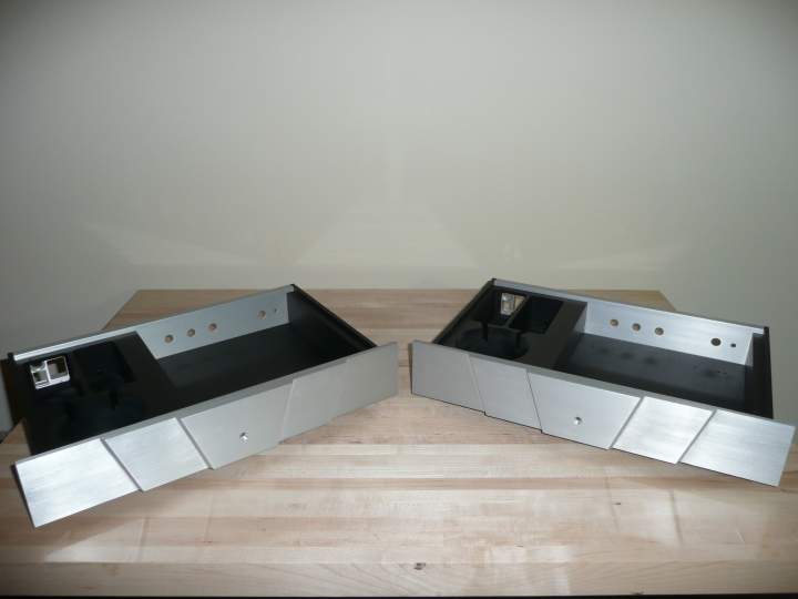

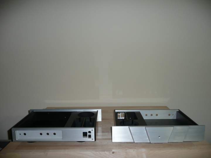

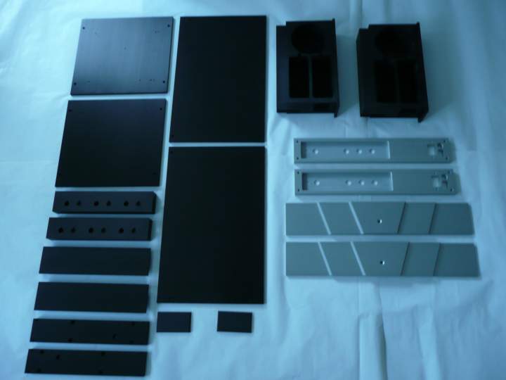

The idea behind the box for the ASP was to make two separate enclosers so just in case if I want to go with two 6B SST2 I would able to put each with the amp close to the speakers and most likely silver face plate because I like the silver face plate on Bryston.
And here is what cost me to come home 2am in the morning.
This the face and back plate just out the machine.
and this is machined out of solid block of aluminum for power supply and transformer.
all the parts but the top cover.

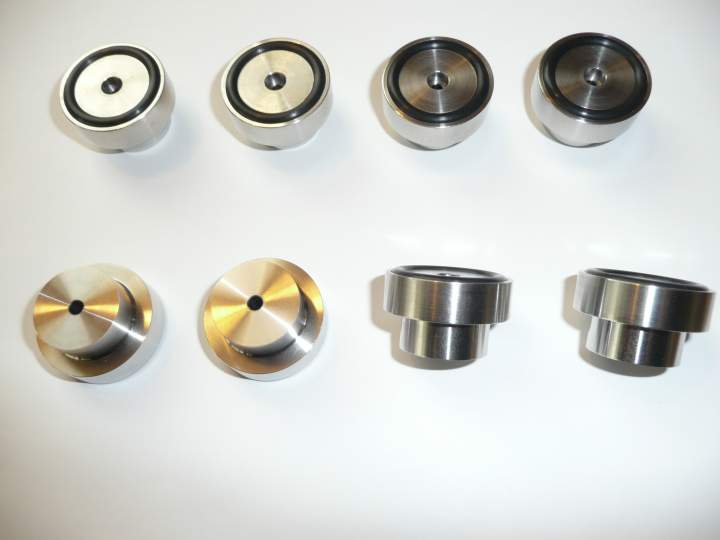

the feetings are made from 316 SS.
I picked them up from anodizing place and put them together and I am happy with it.

Hello Sasha
Thanks for your comment.I machine every thing myself at one of my friend's machine shop.I do work in a machine shop but in order to get this big job done right at work with a boss I have,I would say :thumbdown:

Well,done for today and I finished the crossover and clean up the table to make cables and the power cord tomorrow.
After every thing tested I will send some pictures of the finished crossover.
