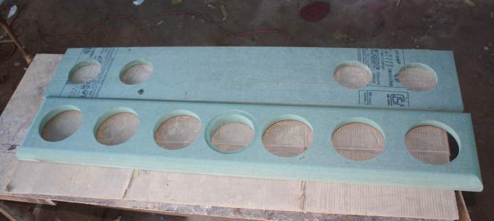

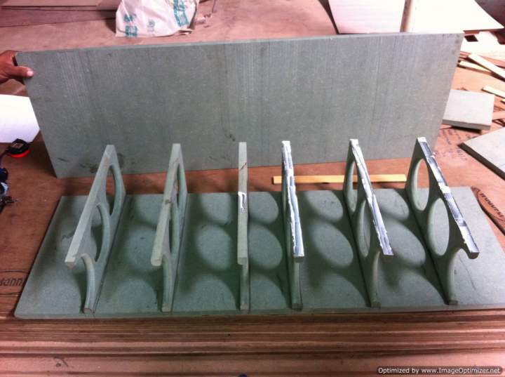

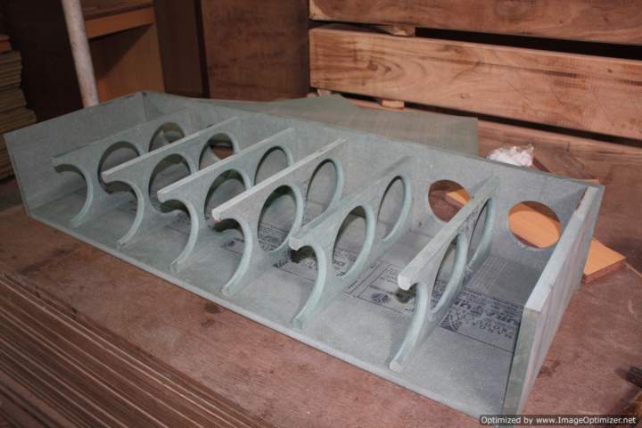

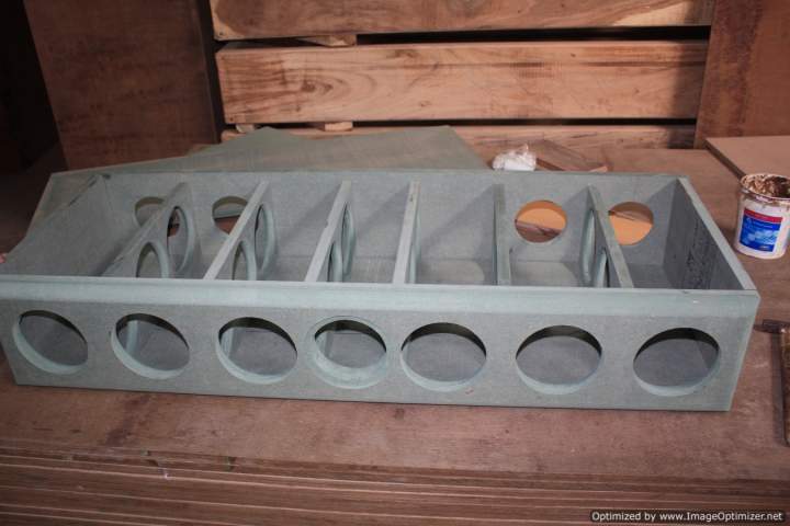

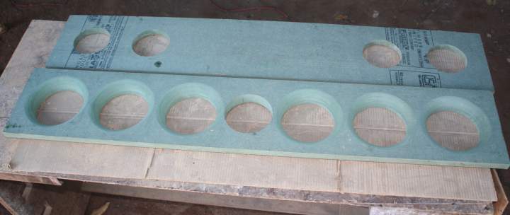

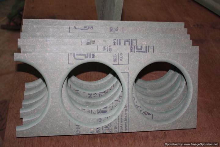

Thanks to threads and pics from Ruben, Nick et al convinced myself to assemble one of this  :thumb:. The center channel in my system was a real weak link in my 5.1 system and been thinking for some time to get a new one. Stumbled upon the LS-C pics and they couldn't have come at a better time. The kit just came in yesterday and I had started work on the cab a few days back. Aiming for the elusive piano black finish. I'm getting the cabinet work done at a woodworking unit owned by a relative since I don't have the resources to do it myself. A few pics.
All panels cut
Front and rear baffles

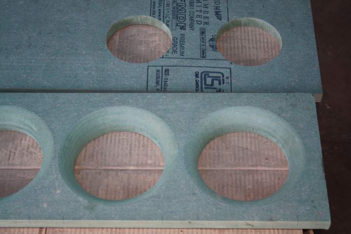

Pretty happy with the round overs.
Dry Fit
Bought all the router bits required for the build and learned a thing or two about routing. Tried my hand at a bit of woodworking and did the routing on the braces. Was pretty fun.

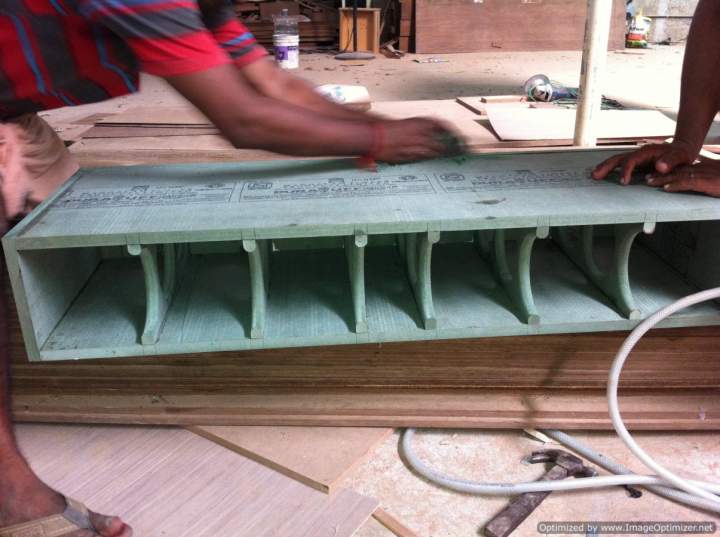

Had the cabinet except the front baffle assembled today.
Need to stick on the bitumen pads for dampening and get the silicone sealant along the joints tomorrow. I may look into a walnut veneer finish if the skins are available. Have to start work on the XO. I more or less remember where I went wrong, since I don't do much of soldering, on the last one so hoping to get better at it. The woofer wiring seems a bit confusing though. Danny, don't know if I'm allowed to discuss the wiring diagram that you sent on the circle so sent you a pm.

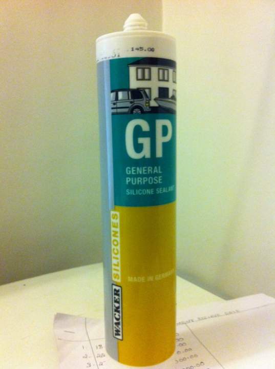

Wow Peter thanks that's great info and not too soon either. The silicone sealant was my idea from the little that I had gathered from some speaker build threads on 100% sealing off butt joints against any air leaks. Its the one in the pic below.

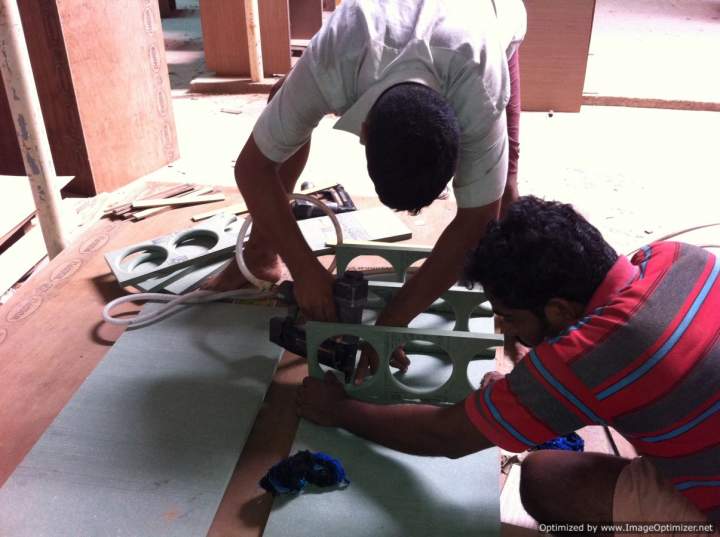

Another reason for the above was I didn't use clamps after gluing. The carpenter was very confidant that I wouldn't need clamps on the cabinet since he had used a nail gun on all joints. Don't know what you call them but it's those thin 1mm nails without the head. The cab looked pretty well glued after the work. He claimed that these nails dont just help connect the pieces but apparently pull them towards each other kind of replicating the work of clamps.
Coming from some one as experienced as you I think I'll stick to the bitumen pads for the corners as well.
