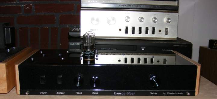

Beacon 4 w/ several options:
Features:
Remote controlled inputs(4) & volume
Separate output w/ tone control
HT Bypass
Artistic maple sides
New faceplate
More details coming up...

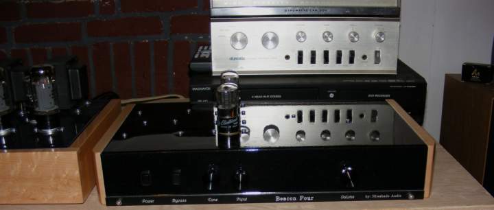

Specialized Beacon Four further explained:
There are two separate outputs. One output does not have the tone control in the circuit while the other one does. There are four inputs selected either by the panel mounted rotary encoder or via the remote through a relay system. The remote does not turn the preamp on or off. A motorized ALPS pot is used so that the audio bypasses all digital circuitry.
A HT bypass has been installed between the first input and first output. Turning it on bypasses all preamp circuitry between the two.
About the circuit:
One 6SN7 acts as a buffer and provides enough current to drive the two output sections. Another 6SN7 is used solely for the tone control. The output is then piped into an output stage. The buffer also provides a signal to the normal output tube. All four tubes have a different job, yet the parts count is still kept to a minimum for best performance.
At this point, the preamp is in the burn-in/tweaking stage and the I/R sensor still has to be mounted. I am considering an external mount for it if possible.
This preamp has been in R&D for approximately a year. Within that time cosmetic upgrades were made (new faceplate developed) and new rocker switches were installed that were found within the past few months. The latest power supply revisions have been installed as well. Updates to the preamp circuit were installed and the tone control is new, something we never had available until it was requested.
NOTE: There is never a charge for added upgrades when an ordered product is part of a R&D program, no matter how extensive.
More photos will be along shortly.

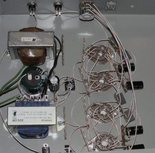

I know this topic is old but I believe I have this very preamp  that is pictured. I can tell by the markings a scratches on the transformers in the last pic, they are the same. It has not been completely finished. The wiring is not complete. There are two red printed circuit boards on it. One has a motorized alps volume control. So my question’s are did Blair make or complete any others? Does anyone have one of these that can post a pic? I would love to complete this and try it out but I would need more info and help. I can solder but I’m not a builder. I can post a pic or start a new topic if needed.
