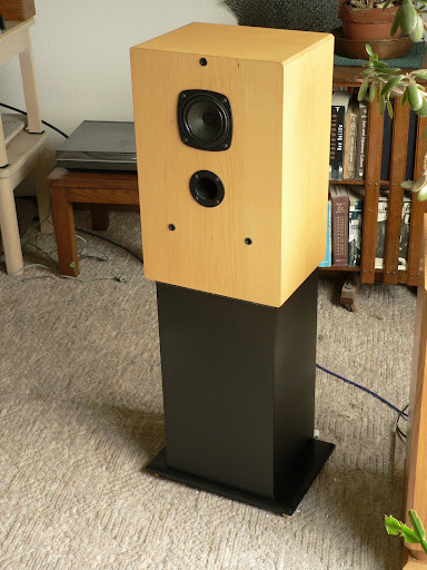

I built these speaker stands flush to the speaker faces in an attempt to enhance the lower frequencies. Since I needed stands anyway, I decided to try the theory. I'm not really sure if it was that effective because I was in the process of making other changes to my rig at the same time. Some call this adding a "beard" to your speakers.

I've always liked the look of full pedestal stands (otherwise the speaker/stand looks top heavy).  Your's is particularly striking to me (black with black driver/port).   :thumb:
Plus you can fill the stands with shot/sand/whatever to make them sound better and add stability.

Yes, there's ~100lbs of sand in each stand added to 45lbs per speaker makes moving them a #itch.  :evil:
