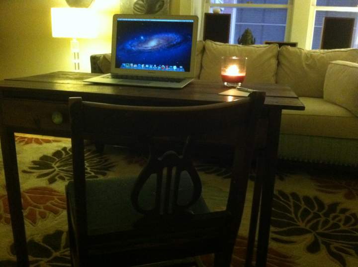

LA mitchell
I feel like I'm VIOLATING some kind of AUDIOPHILE-CODE by putting my speakers
on a shelf on either side of the amp...  I realize I'm not going to get a really
nice SOUNDSTAGE from this....
I'm just wondering if I am losing any other BIG BENEFITS by not putting
my speakers on proper SPEAKER STANDS?
Can someone alleviate my mental-anguish so I can just enjoy the music?
Thanks!

Looks to me like a window ledge, which will be far more structurally rigid than any bookshelf, so its vibration will likely not be as big and issue as reflection/diffraction from very close boundaries.
Try setting the boxes closer to front of window ledge and closer to the side walls of window recess.  If you could manage something aesthetically acceptable acoustic treatment at the corner, so much the better.
