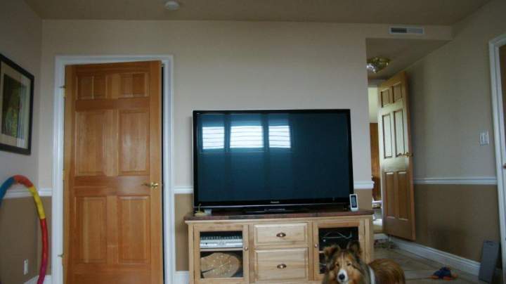

We need a picture!!!  :thumb:

Picture coming...

I'm assuming that's glass in the doors of your cabinet?
How about removing the glass, replacing it with acoustically-transparent fabric, and place a small bookshelf speaker in the bottom of each side of your cabinet? Of course, that sweet clock will need to be relocated, and the pets will need to move.
Or, remove that bottom center drawer and do the same thing. Or remove both the top and bottom drawer and do the same thing (but with a larger speaker).
