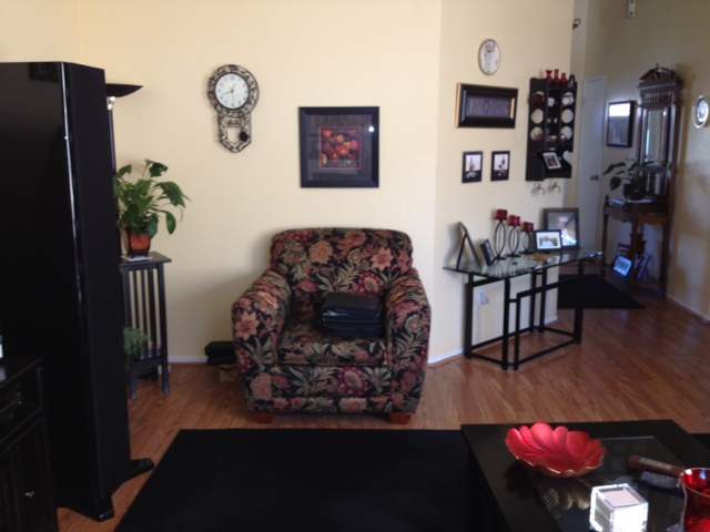

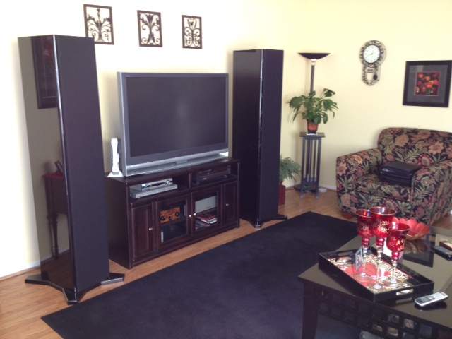

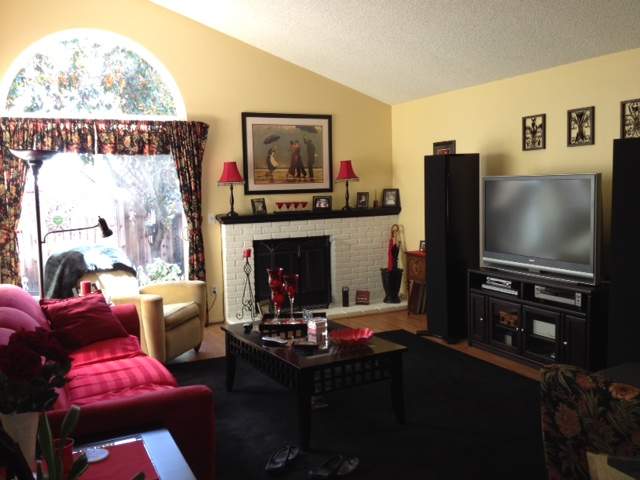

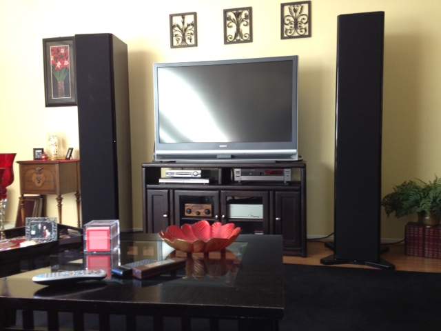

Left Wall
Right Wall
Front Wall
I found them.  Here are some older pictures of the room.  The speakers are just a little bit more into the room today.  1 ft 8 inches.
Check out the red sonic resonators. I got them at Walmart.
