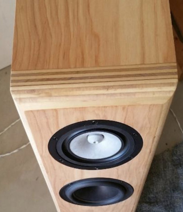

alanhuth
  • Posts: 36
Re: ***X-SLS & X-CS Encore, AV-1RS Build***
« Reply #108 on: 17 Jan 2020, 05:57 am »
Hi Peter,
This is what the speakers would look like without veneering.  I’m not sure how the plywood ends were treated, but it looks pretty good to me.  I’d like to veneer, then trim off the edges and put your edgebanding on, but going the exposed plys route seems posible, no?
alanhuth
  • Posts: 36
« Reply #109 on: 17 Jan 2020, 06:02 am »
This is a flat pack kit I’m building.  My woodworking skills and equipment are non-existent.  Just slapping some hardwood into the edges is something you can do in your sleep, probably, but it would take me a month of Sunday’s.   If I go the veneer-then-bevel route, I will need to borrow a friend’s router to do that.  And pray i don’t screw up.  I think your edgebanding looks better than the exposed plys.  My plan is to use pretty dark veneer.

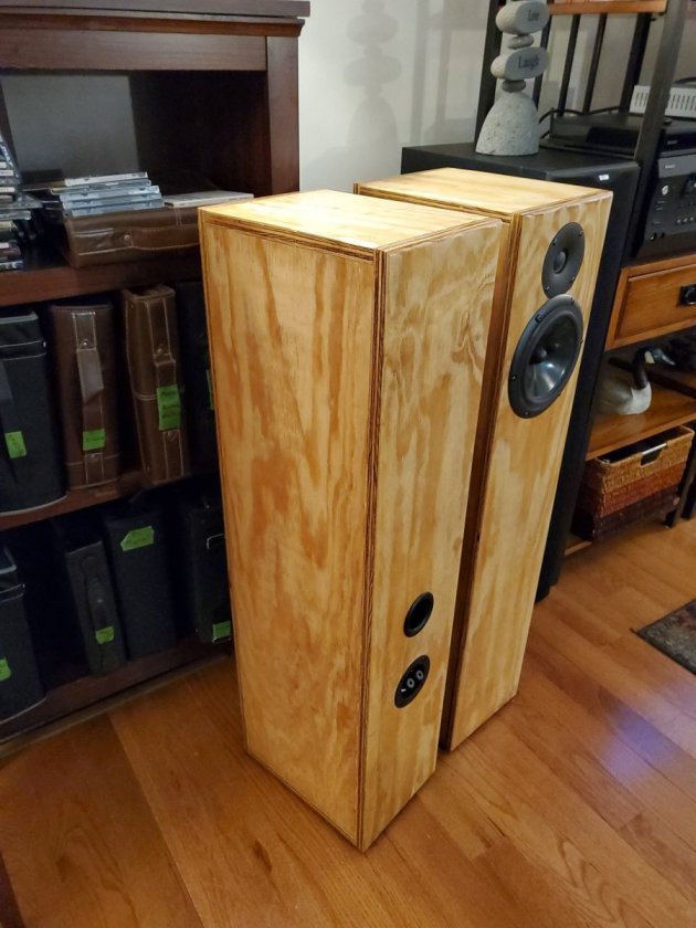

Donnie Mulligan
« Reply #117 on: 5 Jun 2021, 05:43 pm »

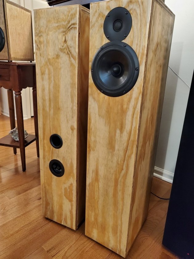

Here are some pictures and youtube links to my Gr Research X-SLS Encore build. Cosmetically they turned out okay, sonically they are amazing. A great Bang for the Buck audiophile quality speaker.
Gr-Research X-SLS Encore Build youtube link:
https://youtu.be/IY-tk1AAxi4
Gr-Research X-SLS Encore Sound Demos youtube link:
https://youtu.be/FfBfNfXfmYs

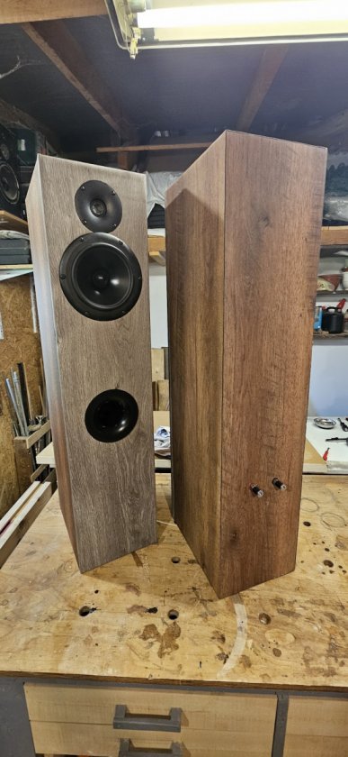

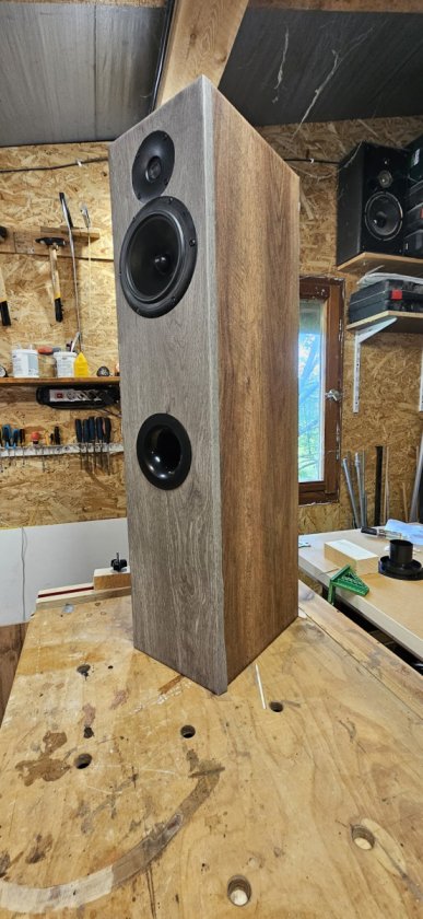

« Reply #118 on: 29 Apr 2025, 07:57 pm »
Hello All,
I rebuilt my X-LS Encore to X-SLS.
Sound is become more brutal, the soundstage will be fantastic compare to X-LS.
I'm very very satisfied with the result.
