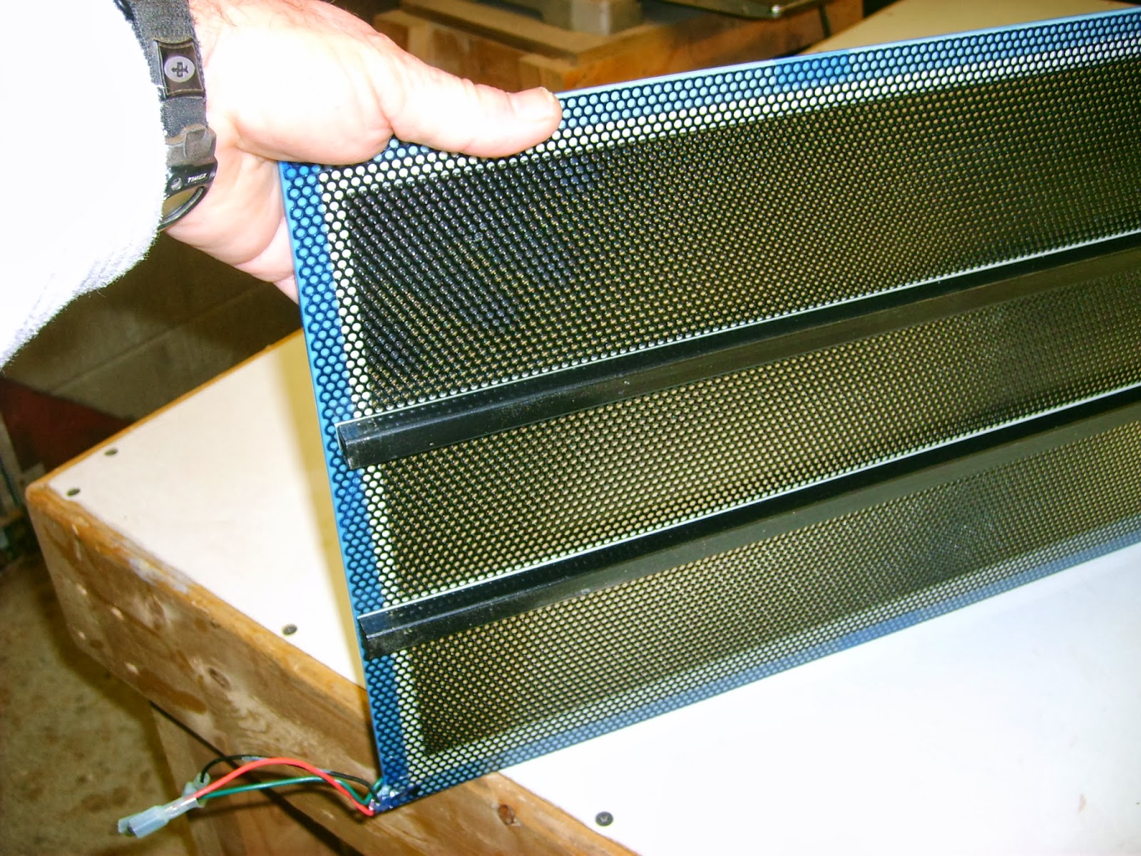

Perf metal sheets are popular though they need to be put in a rigid frame and perf metal is actually rather expensive. (perhaps someone knows a source better than Harrington and King). Then there is the coating which has to be done and tested for possible arcing spots which have to be touched up.
All things considered, I still recommend the Acoustat panel for its low cost and availability.
OnlineMetals.com sells precut steel perf pretty cheap:  .036 x 12 x 48 / 40% open / .125 holes @ $20 each, and you can order custom sizes.
I would love to try my hand at building the insulated wire / light diffuser stators you described, and if you have any build photos, I would love to see them.
« Last Edit: 22 Sep 2012, 03:50 pm by Roger A. Modjeski »
Thanks for the suggestion. I encourage those interested in making their own panels to visit Jazzman's site. I have found his methods to be very practical and thoroughly explained.  http://jazzman-esl-page.blogspot.com/2010/01/building-stat-panels.html
I would also suggest this one http://www.onlinemetals.com/merchant.cfm?pid=13500&step=4&id=1003&top_cat=0. It is 1/8 " thick. One might go to the 1/4 inch hole size.  If you use the steel that's only .036 that is pretty thin and would need some bracing internal and external to maintain a constant gap.
Good point.  My preference for perf metal stators is 18-gauge (.048") with 1/8" max hole size, which gives very good efficiency.  Online Metals does not offer a suitable perf in that thickness, but I've found that their 20-gauge (.036") perf works just fine for 12" wide panels with 2 center-support spacers; especially if you bond on a couple of steel bars for mass and support as shown in the photos below.   The photos actually show a panel made with even thinner .030" steel perf, 51% open with .117 diameter holes (very efficient!)--- with a couple of 1/2" square iron bars bonded to the rear stator for strength and dampening.  The square bar stock is precut 1/2" x 48" purchased from Home Depot ($6 each).  The added steel bars work very well for damping vibrations.
Curved panels can use thinner perf but the .036" perf from Online Metals works OK for 12" wide flat panels.  I would not go thinner than .036 for flat panels.  As is always the case with metal perf stators, flatness is an issue and you can't count on any perf being perfectly flat... so I also advise using short spans between the center support spacers to accommodate stators that aren't perfectly flat.  Sanders' Cookbook recommends setting the span between support spacers at 70-100 x d/s (diaphragm/stator spacing) but I recommend closer to 70 than 100 for the reasons just stated.   :thumb:
Roger A. Modjeski
Re: ESL Independence Day
« Reply #68 on: 23 Oct 2013, 02:33 am »
nice panels Jazzman. Do you have some capacitance measurements? What is your typical diaphragm to stator spacing and polarizing voltage?  I have found that lower distortion at high levels is obtained when the polarizing voltage is half the voltage that produces noise in the panel. Although some say to put the polarizing right below the noise value but then the noise is occurring on peak signal though it is covered up by the music. Reducing the polarizing really cleans things up at high levels.
