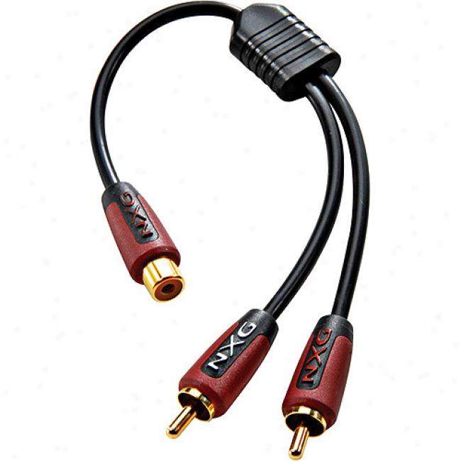

Thanks for the picture, so could I just get two of these guys
and two of these guys?
Would that work? Take out both jumpers, plug both rcas in there, then put both rcas through the small rca y cables?

Because you are going "right next door" to get the Pre-out back into the Main-in, you could eliminate extra connections and one set of RCA patch cables by getting
2 X RCA Male to 1 X RCA Female
Y-cables like this:
