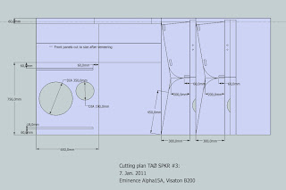

Dimensions are
Width 750cm
Height 650cm
Sides 30 to 20cm wide.
Here is the cutting plan:
http://3.bp.blogspot.com/_C7bws0dOpF8/TSeB-YOCqtI/AAAAAAAABM0/co_ZeBjlulk/s320/Kappeplan+TA%25C3%2598+SPKR%25233.jpg
Presently the Eminence Alpha 15 is low passed with a 4,7mH Jantzen P-Core.
I have only listened to them in the big workshop at work, but I am pretty pleased with the sound in that room, As are my colleagues, there is always somebody trying out there music on them.
Future experiments include digital EQ of the B200´s rising response, and trying a 500Hz second order crossover for the Alpha 15A.
