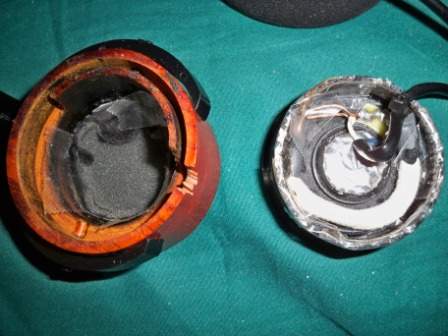

Here are better pics for you Mark..
 Mark while taking these pictures for you I had a brainstorm....another WOW moment..

Interesting design the way he mounts the stock plastic front into the rear ring - my cups are just slip over rears, that will friction set over the front plastic stock ones.

Mark- i don't have a soldering iron so I asked him to just notch them. So anyway after I took those pictures and because my ankles were swollen like thighs and the pain was so intense I spent the wee hours goofing with these and in general they made everything bright, some recordings were perfect and others were bright and fatiguing....so....I was thinking.... the notch for the cable made him put in the rim so the plastic driver tray didn't slide to far up into the shell and crimp the cable so the chamber behind the driver was much bigger and more resonant because of the wood and the screening that Bill so kindly installed for me...I needed to dampen it some how so I took apart the 125's and took out that thin foam I had inside as a cap with the plastic mesh and button behind it. I put the shells with the screen side down on my desk and used a pen to push the screen flat and level with the shell, I added as much of a 90 degree angle as possible and then I took the thin foam and pushed it in behind the screen and BOOM!!!
Everything now sounds perfect, no more edginess...the wood sounds great and now with that little bit of foam material up against the screen its like thats stuff Danny sells...darn, the damping stuff but it still haas openings in he foam...
 I think these are done and I'm serious when I say they sound the best of ny headphones I have ever heard in my life...LOL and they look cool as heck!!!

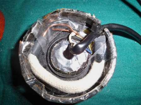

I'm pretty much homebound right now so I'm bored but the tunes are good, so check this out..I added EVS Ground Enhancers inside each shell attached to the negative terminal in each ear cup/driver.
WOW!!!!! This was what I was thinking about when Bilavideo told me he'd send me some shells. I figured while I'm in there messing around I'd install an extra pair I had and make uber Grado's and it worked... boy did it work!!!
Would you please be so kind as to post pix of how you have the body of the enhancer rest inside the cups?
Could you post a picture of how the body of the evs enhancer rests inside the cups? Thanks in advance!

stratocaster-sorry I just caught up with this thread, here are pics for you:
Very temporary for the moment, notice the tape, but I do not have soldering equipment so I wanted to hear it first, I like it alot...gotta buy an iron now and become officially a DIYer...
