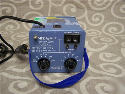

TheChairGuy
Re: Re: Welcom to Power Conditioning!
« Reply #8 on: 24 Dec 2011, 04:15 pm »
I've contemplated an isolation transformer on and off or years.  Wasn't sure if it would constrain the sound or hopefully lower the noise background and let 'er rip.
Anybody else use an iso unit?
On CD/DVD/DAC's an isolation transformer is one of the best and more cost effective upgrades you can make to your digital front end, I've found.  It may have positive affect in 2 ways: feeding your digital gear 'cleaner' power and acting as a wastegate to contain digital hash from leaking into your downstream amplification gear.
Because the power draw from the digi front ends are minimal, a very simple and inexpensive isolation transformer can be used.
Used elsewhere, the effects were mostly negative.  Perhaps a larger IsoTran is needed on even a preamp, but the sound was constricted when I tried it on that component. Overall, for me over the years, less power conditioning has meant better and more unforced sound in my home.  But, an Isotran on your digital gear is tantamount to sweet, sweet, music  :thumb:
I use an old VIZ Isotap II (Model WP-27A) for this purpose: I think it was under $90 with shipping from ebay maybe 4 years ago.
