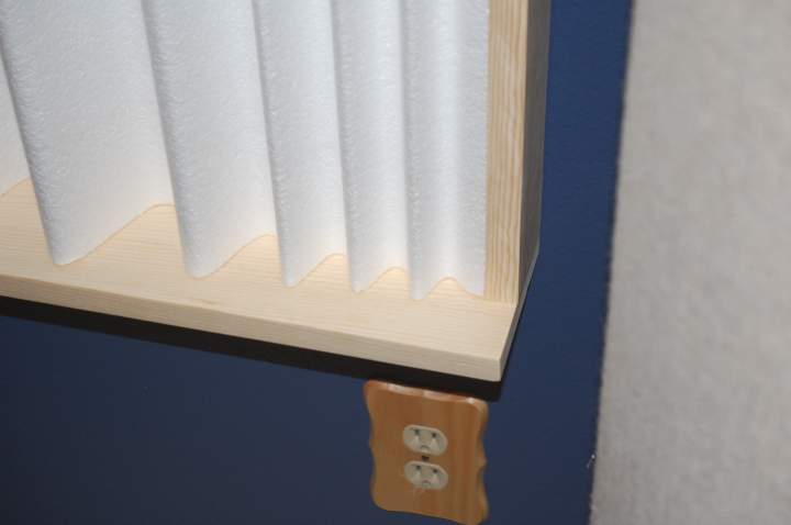

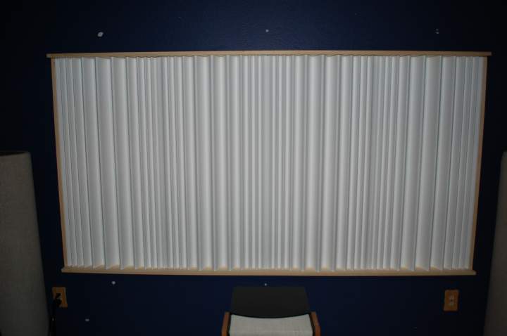

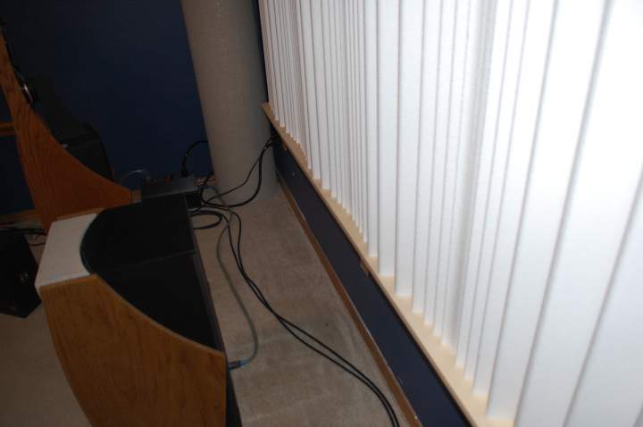

Dave,  The frame work I have planned for these won't be as fancy as say the work I did on the absorbers on the rear wall of my room.  I was trying to copy the look, angled edges, of the side panels.  I had more of a simple frame in mind, 8 feet long 1 x 6 fastened to the wall on edge as a shelf for the diffusers to sit on and another on top as a top cap and then end caps to complete the frame.  My other panels had wood placed between the individual  absorbers, I don't have the room for anything like that with the diffusers since they fill the entire space I have and I wouldn't want to disturb there work with that flat panel between each one.

Be sure to try them flat against the wall and then moved out about an inch so they have a little room to move and can do a bit of mid and upper bass energy absorption.

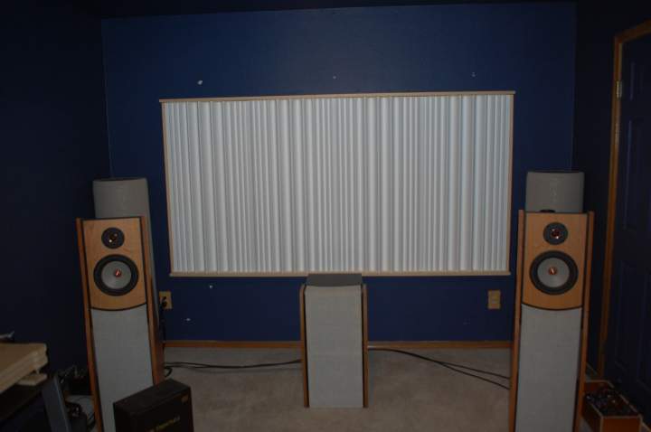

Here are a few pics, as I said nothing really fancy just a basic frame.

They look great in that frame.  Are you going to paint them?  Flat paint will retain some of the HF absorption characteristics of the foam.  Gloss will make them pretty reflective for a brighter top octave.  Eggshell seems to be the best compromise.  It sounds open, but not bright.  Two coats sprayed with an airless or rolled with a small foam roller works very well.
Please keep us posted as to how they are working for you.  You have a great looking room.  I'm glad you took those absorbent half rounds out.  I bet it sounds bigger, wider and deeper - BWD is what it is all about - as long as instruments and voices keep their scale.

Dave I am going to paint them just not sure what color yet.  I'm actually going to repaint the entire room, getting really tired of the blue.  I have a airless sprayer and it looks like tomorrow is going to be a great day for painting in the garage, forecasting a high of 73, so I better figure out what color.

How are you liking the diffusers in between the speakers as shown? any more thoughts?  Much different from you previous sound with the half cylinders?

Man those look really nice!! Great job! :thumb:

jriggy  I really like these diffusers.  The half rounds did almost nothing compared to these.  The soundstage took on a new depth that my system has never had.
