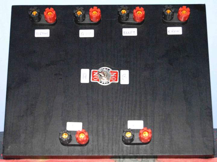

Hi Brian.
This morning (In Vietnam) I did a side by side test of the GR Research V-1 and V-2 with my DIY speakers switch box.
I like to switch within a few second from A to B speakers to hear right away the sound difference. It's the way I do it, maybe not your way of doing it.
For the V-1 (97db efficient) the volume control of my MS-15 (10 wpc) was set at 11 o'clock and for the V-2 (93db efficient) I had to crank it up to 12 o'clock. Not much more.
The litening volume was plenty loud to get in trouble with the neighbours...
Therefore, with a 10 wpc amplifier and efficient speakers, not need to have 100wpc + expensive amplifier, however, later on, I will try a 30 wpc NS-30 to see if the sound peaks/burst will be reproduce.
The results of my test on the V-1 vs V-2 will be posted this weekend on GR Research Audi Circle site.
