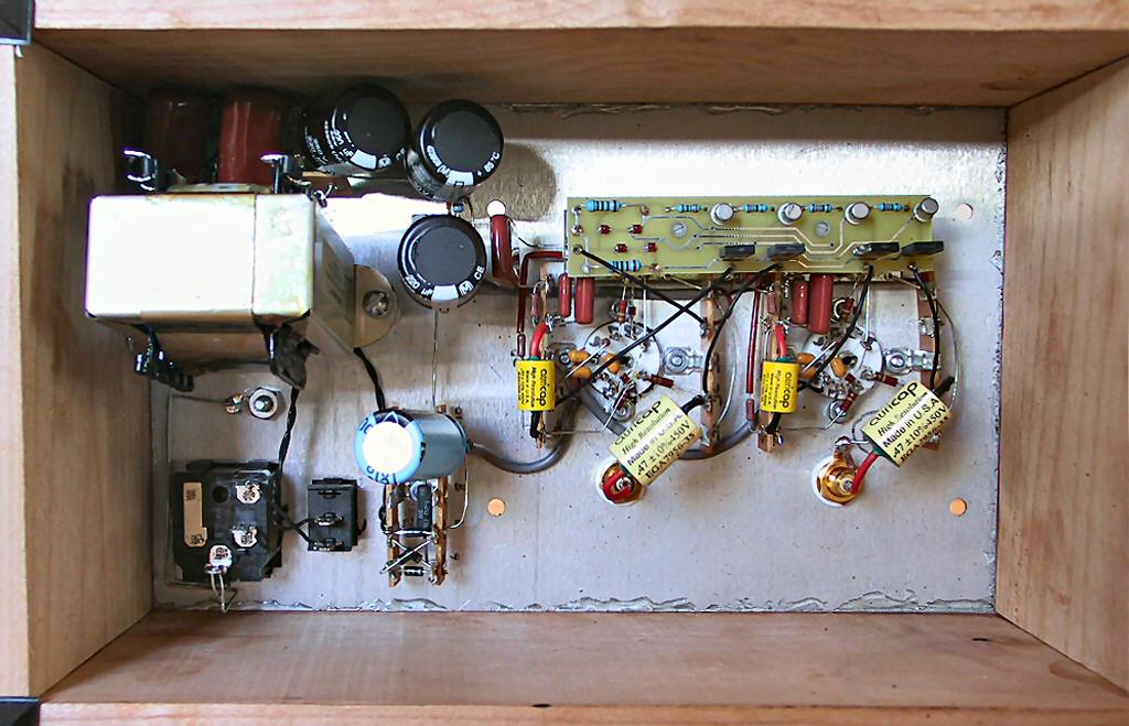

If you are looking at DIY tube phono pre-amps then the a Hagerman Cornet2 should be on your short list. I built one to compare to the Bottlehead Seduction with C4S and there was no comparison, the Cornet2 has more of everything - tonality, inner detail, imaging, bass definition, and clearer highs. I immediately sold the Seduction to an AC member who then re-sold it a few months later.
The Hagtech Circle has a lot of Cornet2 building tips, I recommend the Mondorf SIO caps bypassed with Russion FT3's.
My old Seduction
The Cornet2 with Russian FT-3 bypass caps
Wayne

There is also an octal version of the Cornet2 that uses 6SN7 tubes, some say it sounds better. An octal search on the Hagerman Circle will yield four pages of posts.
www.hagtech.com/pdf/cornetoctal.pdf

Have you read about the mods tubesforever did to his Cornet2? Adding the FT-3 caps to my C2 came from his writings.
"The C2 created quite a stir during my trips.  No one thought this Hagerman could stand up to a Lamb or Thor.  No problem at all actually.  The C2 surpassed both by a comfortable margin.  The bottom line is that my slightly modified C2 beat out some big names out there."
http://www.audiocircle.com/index.php?topic=58941.msg523190#msg523190
