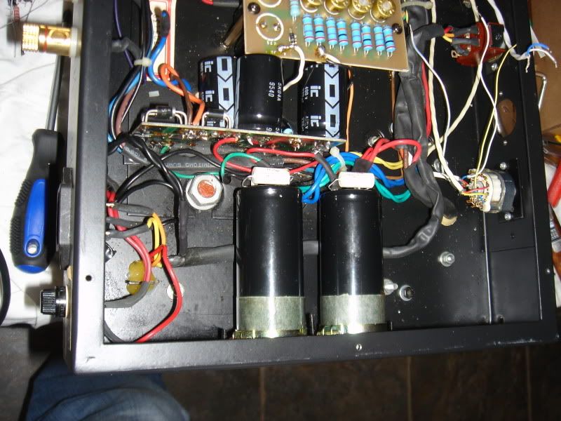

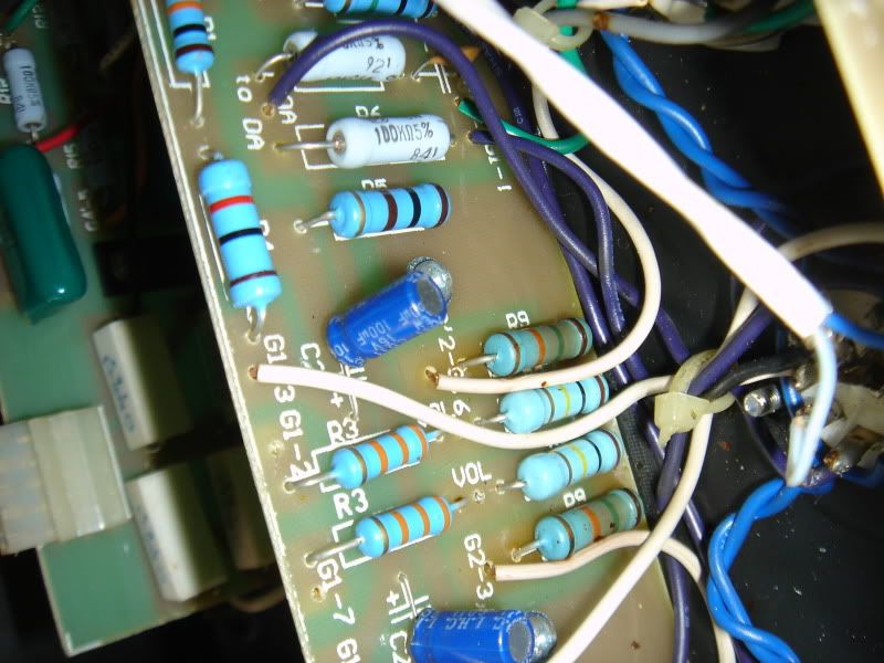

I have a couple of burned resistors on one of the boards. I willl replace those but would like to know what would cause this, and if a differnt value can be used to stop this probem. As for my questions

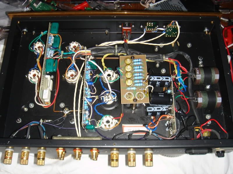

Internal pic of amp (for those that havn't seen one. I couldn't find any on the net)

 The 801 you have is a very old version. Looks like second generation. You will propably not find a schematic for this model anywhere and it has a different circuit as compared to any of the later version. Unless you are sure your schematic is for this older model, it will do you no good.

 The resistors shown that are showing signs of burning are probably fine. They obviously do get pretty hot and it would be a good idea to replace them. I would use 5W Dale CW wirewound resistors here.

Replacing those silicon diodes will also make a difference

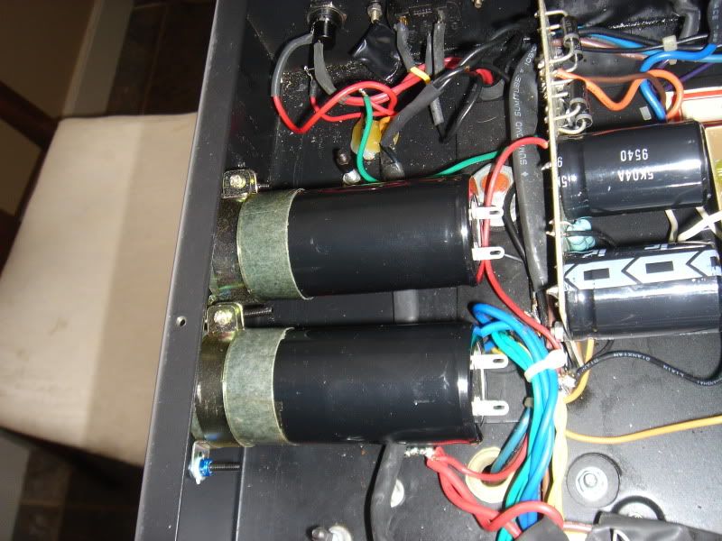

Today I replaced the 470uf caps with jj 500uf 500volt caps and bypassed them at the terminals with a couple mundorf zn 0.1uf caps. Hooked the amp back up for a listen. I was quite amazed at the difference I could hear already. There was more sparkle in the top end but the bass was Much better. It changes from one muddy note back to a wide range of music that blended into the mids much nicer.

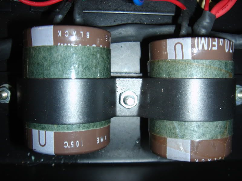

The new caps were a bit tricky to get to fit. they are twice as long as the old ones. I ended up using new clamps and mounting them to the side panel.
Heres a couple pics
And soldered up with the bypass caps
