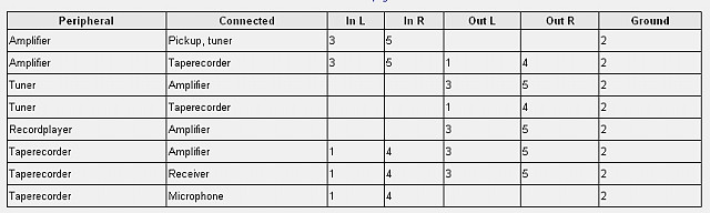

Since I do not have the tonearm in hand to check for connector locations can someone tell me the standard termination locations for the female 5pin connector?
thanks in advance,Bill

Take a look at this:
---Gary

Looks like they are only using 3 wires for the phono hook up, could that be right?

I've never wired one of these up so I'm only able to pass along the "official" wiring diagrams.  But since the DIN connectors sometimes gets used for both input and output wiring, it does make sense that they'd use a common ground.  But you won't know for sure until the tonearm arrives and you can measure it for yourself.
