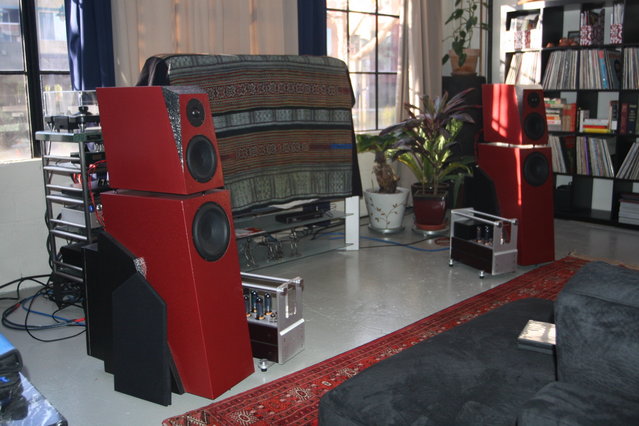

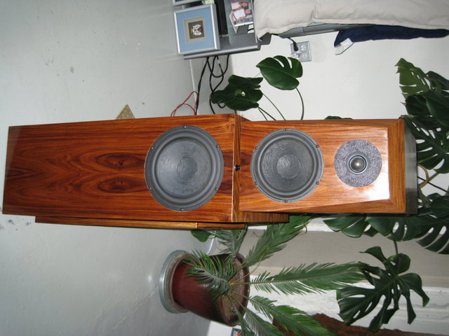

Hi there, I recently got my speakers, once painted red/black, veneered in rosewood and stained!  It looks great, but the Shellac finish on it is not consistent.  I was wondering if anyone in the group has experience finishing veneer and would be willing to help me to refinish them....
Here are some picture of before and after.  Note that you won't be able to see the finish unless you're up close.
Thanks in advance!

Thanks for the advice...  I've tried touching it up and it seems every time i do, it gets worse.  The problem is that there are places where you see drips / runs of the shellac, others have the brush marks, especially on the bottom cabinets where the diagonal piece runs on the main sides.  I tried doing the "french" polishing, but i guess, I can am unable to get it done.
