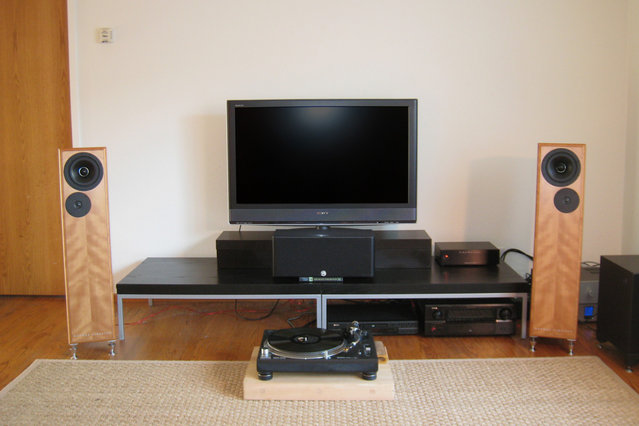

I also like the auralex space array's sculptural and natural simplicity but I don't think I need diffusion and the price is $$$. These could be DIY but would need a lightweight wood.  hmm maybe I need to create a floorplan drawing to get some opinions.  and I just did....
proposed panel location shown (green)
Cheers, ed

And.... Q: Would Wall-A (shown in drawing above) benefit from Diffusion or Absorption? pic here
 thanks, ed
