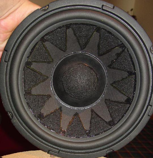

One last pic:
There was also a shinny clear coat that was sprayed over the entire woofer.

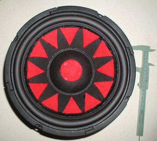

Companies have been doing this stuff for years. Does this speaker look familiar?
laserman
  • Posts: 265
  • Ambiguous-Optimist
Re: EnABL'd woofers testing
« Reply #17 on: 18 Sep 2008, 09:57 pm »
Danny,
Yes, Dunlavy made some amazing speakers...large and small sweet spot.
Here is another one done in red
