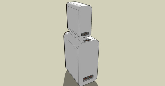

Final concept
« Reply #6 on: 3 Jan 2008, 05:19 pm »
Here are the last of the concept drawings for the TS3 design cabinets.  Three pairs of cabinets will be built as follows:
1.  White micro perf shell with solid Claro Walnut baffles, rubbed to high gloss
2.  White micro perf shell with solid quartered Wenge baffles, satin wax finish
3.  White micro perf shell with solid Bloodwood baffles, satin wax finish
Two pairs of cabinets will be available for sale through my shop to be used with Ricks designs.  This cabinet combination was designed specifically for the TS3 commission which was, for me, a no holds barred speaker.  They may work with other driver combinations but this is up to Ricks willingness to take on more work.  We are currently very busy in the shop trying to fill commissioned work so we will only be able produce these three pairs for now.  One pair will stay as my personal pair, most likely the Claro Walnut or Wenge, the other two pairs will be available for best offer.  Shoot me a PM for more details.
