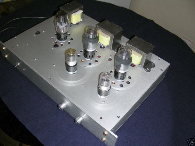

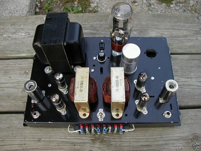

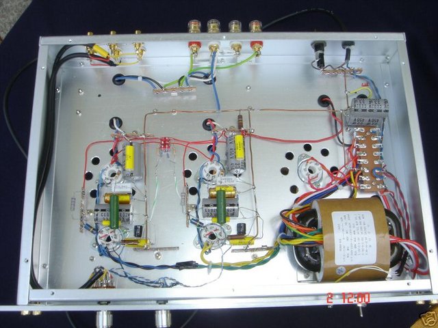

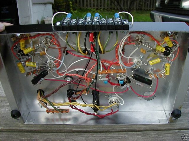

« Reply #6 on: 3 Sep 2009, 04:04 am »
oh i forgot - shameless spam here...   :lol:  i have two amps that might do it for you - completely refurb'd electrohome p-p amp, w/wintage nos french 6aq5 tubes.  makes ~8wpc; better than the wave 8's i used to own, imo.  i'd like $300 for it:
it comes w/a nos wintage philips rectifier, as well as the ruby tube pictured.  i did a simple mod, (lifting one wire) recommended by the builder of the amp below, to allow using the philips tube, which softens the start-up woltage the 6aq5's see, lengthening thier life.  i also have schematics/manual/etc...
or a custom made/designed set amp, by a chinese guy living in australia, w/nos 6v6 tubes making ~4.5wpc.  switchable negative feedback - 0db, -1.5db, -3db.  i also have the schematics for it; this one is a bit spendier - $450:
there's more pics in my "doug's stuff" gallery, if interested...  actually, the pics are there, even if you're not interested!   :lol:
