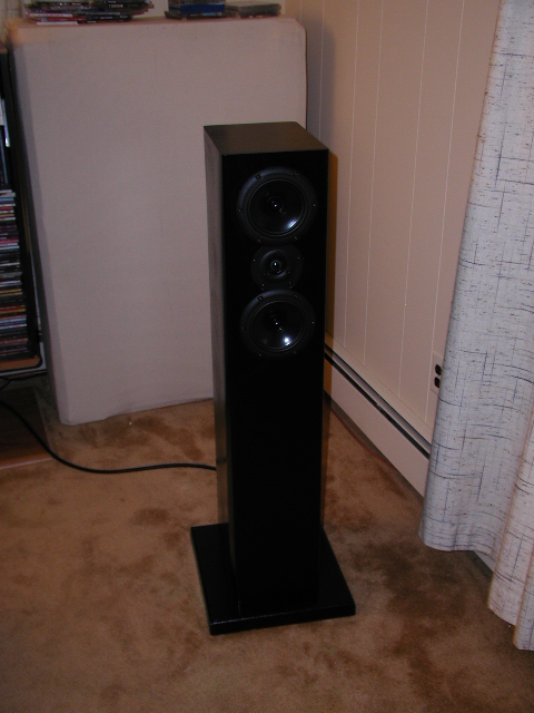

Carlman
Please give me some ideas how to sound-proof my windows!
« Reply #6 on: 18 Jun 2006, 01:03 pm »
I really need to update those photos...
What you need is a barrier that doesn't allow sound through but could also improve your room acoustics.  You will need 2 things; rigid fiberglass and thin plywood.
The plywood can be cut at the lumber yard to fit in your car. *or taxi*  You'll get 4 2x4 sheets from 1 4x8 at $10.  You'll then need 4 panels of rigid fiberglass.  This can be hard to find.  I think they come in packs of 6 around $30.  You'll then need some fabric to cover the panels and a staple gun to staple the fabric to the plywood.  You could probably also use a glue gun.... I'm not sure.  Do whatever you want on the fabric, just make sure it's somewhat breathable.  A lot of people like burlap but I can't hear any difference between that and more attractive fabrics.
But, for well under $100 you could make 4 nice panels that would provide a 2" soft wall with a 1/4" plywood sound barrier on the back.
Good luck,
Carl
