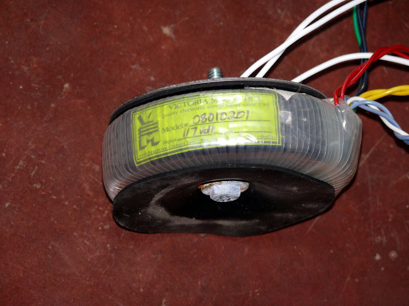

Hugh I think there's been some misunderstanding !! The transformer is not a E&I (from your descriptions) and does not have double primary winding that you mention !! it only has one primary winding with Ground (Green),Phase (Dark Blue),Neutral (Dark Blue) !!
So its not possible to:
Left to right;  0V to Neutral 230Vac, connect the next 115V tag to next 0V tag, then 115V second last tag to Active 230Vac.  ES connects to the chassis and thence to the IEC mains entry module power earth.
On the primary side, there are four tags on the trafos, left to right, marked beneath 0V 115V 0V 115V ES.  That last tag is an electrostatic (copper) shield around the trafo windings.
I have attached the pics of the trans for the reference purpose, Either Am missing something or Am reaaaaaally stupid and not able to figure out :oops:!!

Well, thats not the stock transformer.
I think Hugh should handle the technical details...
The 'stock' ones:
-West

odd ... a toroid and am I correct in understanding that there's only one?
You're probably best off getting a pair of the correct trafos from Hugh if that's acceptable to him. They are only small and postage shouldn't coat too much.
There should be separate outputs [and voltages] for the tube filaments, low tension and high tension.
A transformer doesn't have any inherent frequency built into it so the point West makes is valid as far as 50 - 60Hz goes.
Jules
AKSA
Re: Rewiring GK-1R from 230V to 115V?
« Reply #9 on: 22 Apr 2009, 08:51 am »
Hi SG,
Jules and West are correct, that transformer is an off the shelf version from Victoria Magnetics, in Norcross, Georgia.
God knows how the guy got the boards, without the transformers, don't recall that one......
You really need the original transformers, two are required at $AUD50 each plus shipping.
Email me privately if you would like the ratings.
Hugh
 Jules there two of those ! I just took pic of one  :wink:!!
Yes but offcourse ! it has a 150V,15V and heater supply ! there is no probs with the trans or the specs of it ! It was being used in the US before he came to India !! so there's absolutely no reason for me to believe that the trans has a prob or otherwise !!
I have no clue or idea !!
How much would shipping cost ?? if I plan to junk this trans and order from you ??
Have sent a PM regarding the rating info !!
