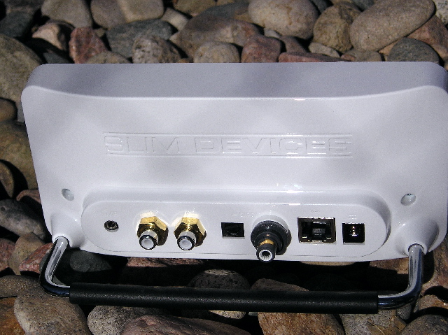

The information about the SB3 analog only and full mods is now up on the BOLDER Cable website.
SB3 analog only
SB3 Full Mod
There have been a few changes in regards to the parts used and the degree of work involved in the mods. The cost has gone up a bit from the SB2 mods.
I have just completed two of the full mods for a couple of AC members. Hopefully THEY will comment on the workmanship and the sonics in the coming weeks.
I am currently backed up 8 weeks or so on mod and power supply orders. If you are interested in getting a mod done, the best thing to do is place an order through the website to reserve you spot in line. Use M/C or Visa to pay for the order. You will not be charged until the order ships back to you.

The mod is basically the same concept on both the SB2 and SB3. Remove and replace the capacitors in the power supply with higher quality, low ESR, higher value types. Remove and replace the DAC chip with the higher spec'ed version. Run the analog output direct from the DAC chip to new RCA connectors through some high quality coupling capacitors.
The SB3 case design requires the the main DC input cap be physically smaller than in the SB2. The same thing goes for the analog output coupling caps. There is just no room for the very large Sonicap film caps.
As I have been modding and listening to different power supply caps, I have noticed that the Panasonic caps sound a little "dry" or "sterile" compared to the very LARGE and EXPENSIVE Jensen four pole caps. I have tried to come a bit closer to the warm analog sound of the Jensens by using a small BlackGate cap in bypass to the Panasonics internally in the SB3 mods.
I have tried out the BlackGates in my own SB2. They have been breaking in for about 2 weeks now. In another week they should be done and I will try to get together with mgalusha and Turk to compare the "new" mods to their units. If it turns out to make a significant difference, I will then offer the BlackGate caps standard with the SB2 mods at a higher price.
At this point, I feel the sound of a fully modded (Sonicap main cap with Sonicap Platinum and Sonicap Gen 2 bypasses with Silver Slipstream Bybees) to be quite a bit better then any digital source I have heard. I do feel that the SB2 will still remain better sounding than the SB3 for analog outputs.
