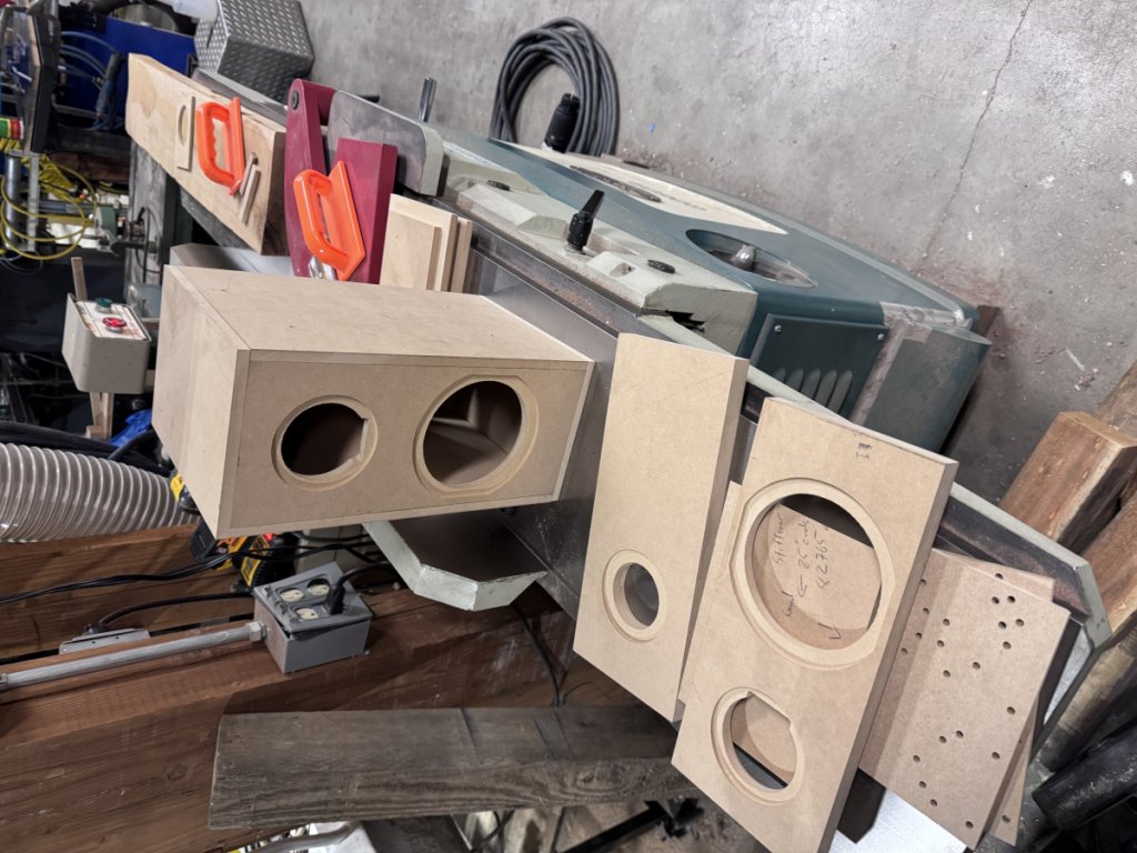

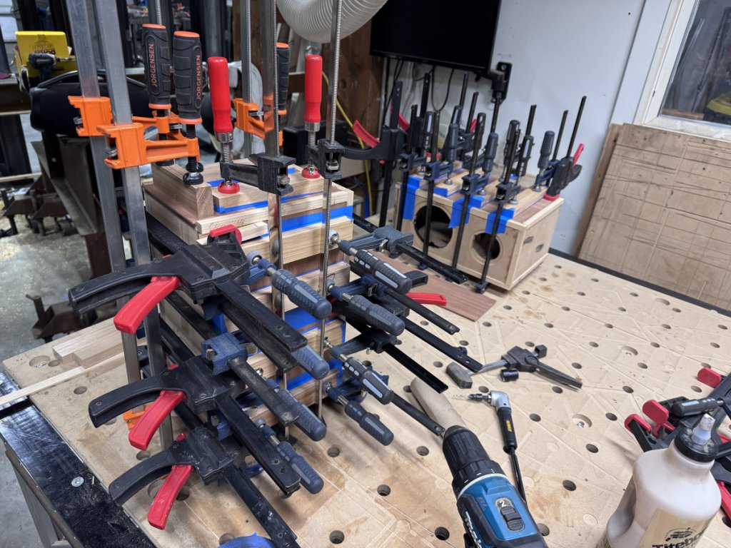

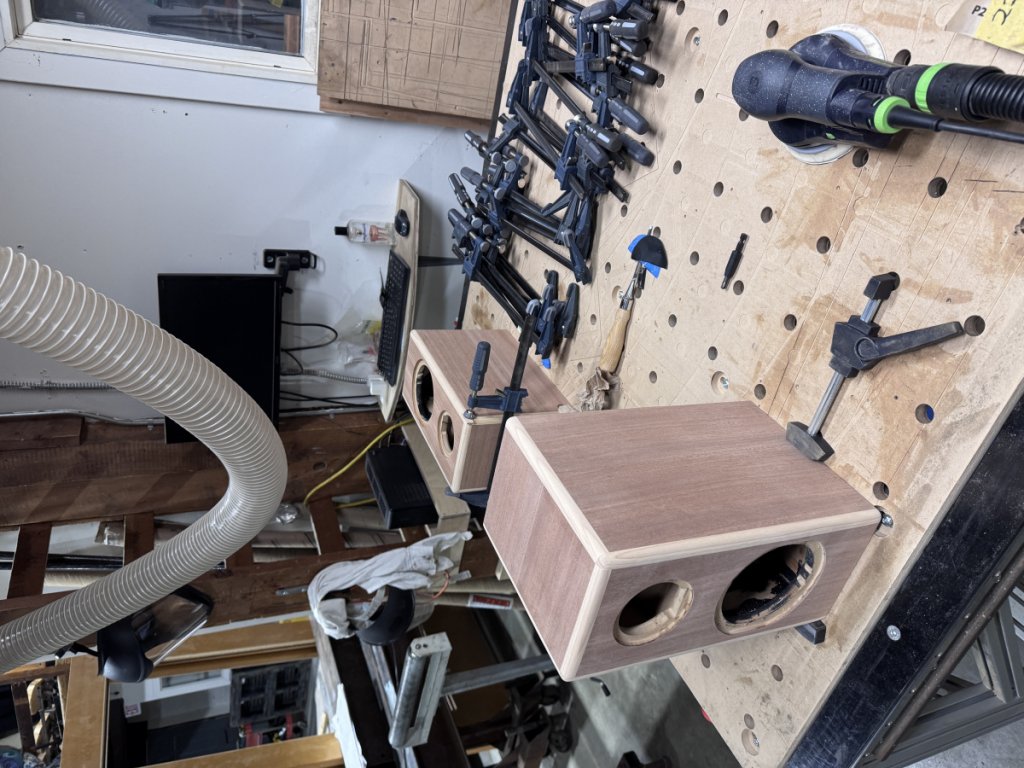

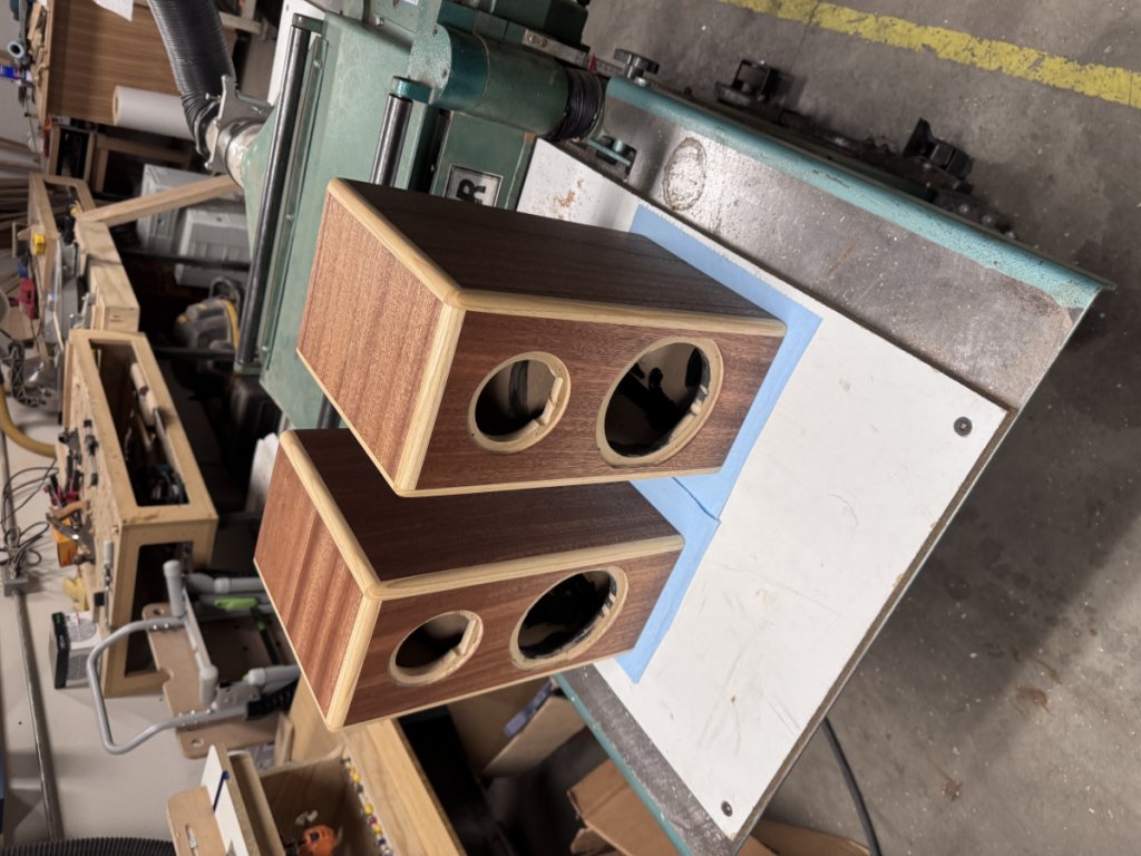

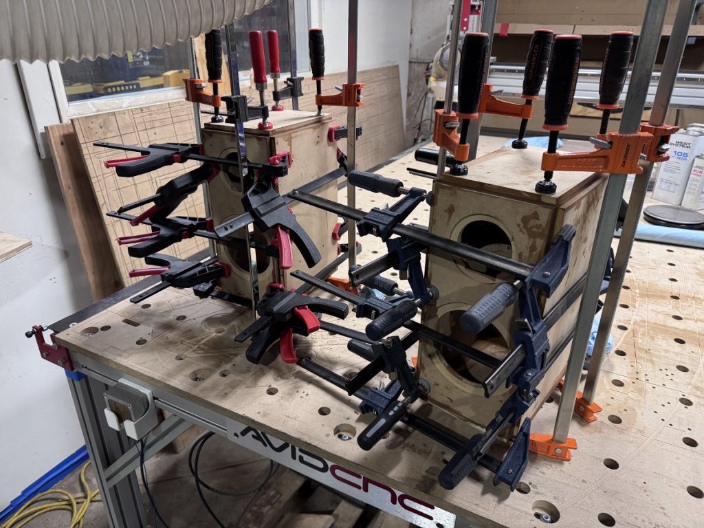

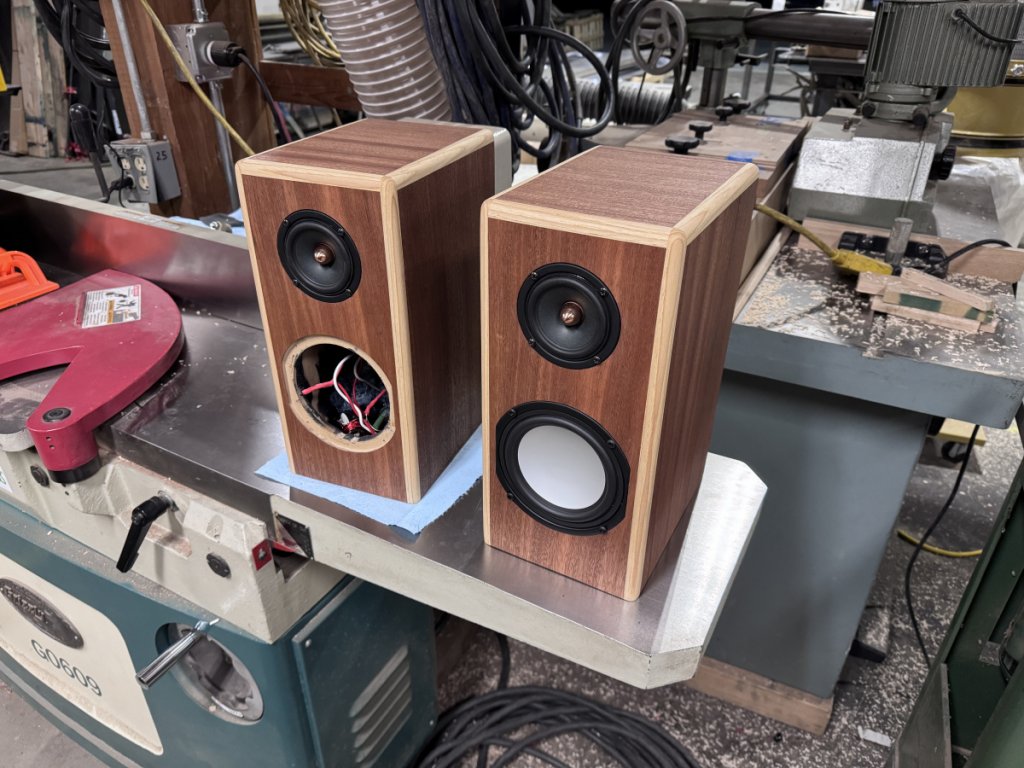

Hello all, I recently decided to build my first pair of speakers and chose the LGK 2.1s, just wanted to share them with y'all and join the community as I start planning the next upgrade! These are my first proper speakers and man I was missing out on a lot, it's pretty impressive how many little details I can hear now. I am running the speakers with the Ampapa Q1 dac and D1 amp and have been very pleased with the performance for near field listening. I have a pair of SX52Bs in the amp currently, still need to upgrade to a 10A power supply though.
The speakers have a shop made sapele veneer paired with ash strips on the edges to allow for the 3/8" roundover. It was quite a lot more work than a standard veneer but I think the final product was worth it.
A few photos from the build:
