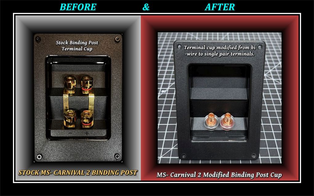

Mundorf already provides this process with their copper foil inductors. I do appreciate the offer, thanks. :thumb:
Not a fan of Bi-wired speakers, therefore I've taken initiative to modifiy the binding post terminal cup.

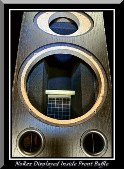

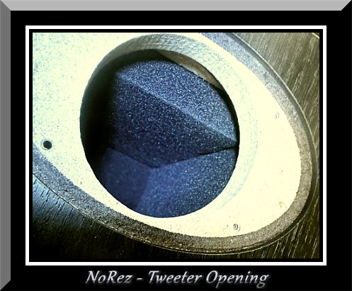

Applied Danny's 1" NoRez, as well as an additional reinforcement dowel rod, making the cabinet more inert.
I followed Danny's suggestion, keeping the NoRez positioned between 3/4" to 1" above the ports, enabling them to function, based on the manufacturer design.
The little 5/8" Dia. dowel rod going between the cabinet sidewalls really makes a difference with how inert the cabinet is now. The MS's are actually more inert than my NX-Studio's with this additional Dowel added.  :thumb:
