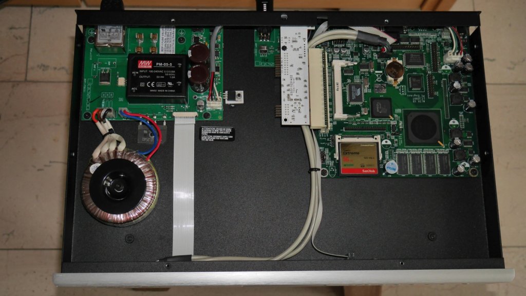

2) Hadware
The BDP-1 player is very well made and uses top notch components (see picture)
However hardware can fail , of course, as well:
AA) Power supplies (5V, 12V , 3.3 V).
These consist of
- 1 Meanwel PM05 5  ,  5V 1A switched power supply (SPS)
   (https://www.koningenhartman.nl/nl/webshop/industrie/industriele-voedingen/medical/mean-well-ac-dc-psu-pm-05-5-modular-5v-1a )
- 1 linear 12V Power supply.
- The 3.3V is derived from the 5V power supply.
If any of those Power Supplies would fail, any competent technician could repair those.
The weakest points are iIMHO, the Meanwell PM05 5 SPS and the 2  big  6800 uF 25V Chemicon electrolytics (but these are Hi Quality and survive > 35 years in Amps)..
NB I do not think that the Toroid transformer will ever fail, but this  is also easily available.
BB) PC Engines ALIX  1D (2007) industrial PC Board.
In case of internal  failure (no beep upon start up: most likely indicates a broken circuit) the BDP-1 is IMHO Totall Loss.
Bryston might stilll have spare ALIX D BOards , but the costs of repair will be prohibitive!
CC)  PIC, USB Front Panel, VDF circuit and switches boards
If the PIC Board would fail, a similar story to BB) above : much too expensive to repair and not repairable if the PIC programme is not available.
- It might however be an sensible idea to stock a spare VFD display
  FUTABA GP1184A01A
  NORITAKE GU140x16G-7003
You might inquire with Bryston Ltd, whether they would be willing to supply a VFD board  to a Private Client.

The "new" BDP-1 Player #000487 , ( if started up properly), works flawlessly on the original firmware of my other  BDP-1 #000410. Selecting nicely and playing without Hick Ups.
However, I have had one occasion, that the player did time out (after 120 sec, preset by the PIC) with an error 09 fault message, but  it again rebooted OK after powering down and immediately powering up again.
I try to understand / diagnose the circumstances at which this happens.
So the new BDP-1  is not fully OK yet.
I have tried an 8GB "WD Silicondrive II"  CF Card  instead of a 16 GB Sandisk Extreme Plus CF Card, but this was most likely not the cause of the slow boot process.
(I'm awaiting a Transcend 4 GB133X CF Card from Ebay, just to be sure (to be delivered monday).
Causes:
- I suspect either the CMOS battery (CR2032) although I already replaced that one (albeit  by a new "Cheapy" candle light battery).
- But I see a that if  a USB stick has already been previously recognized, the  next boot up is successful in 1 attempt.
- So still searching : I f you have other idea's could you please help?
So, either , it looses settings (but I have replaced the CR 2032 COS MOS battery) or there is miscommunication with the USB Board at the front.
I will update you, if I definitely could find the cause.
At any case, I can use the "work-a-round "of "renewed booting.

Glad to report that the BDP-1 Player Serial 000487 from Romania is now fully working again, as it left the factory in 2011.
Reason for the earlier need to reboot it, for "kickstarting"  the player:
A Simple  cause with a grave consequence:  The RTC CR2032 Battery was NOT correctly installed.
At de + side of the battery holder the 2 golden Lips should point upwards, at the - side they should be flat (horizontally).
As a matter of fact, they were both lying  flat on the + and - side and as such, the battery was disconnected.
I had already a strong suspicion:
On could reboot within 3 minutes after appearing of the Error 09 message;
If you would reboot after longer times (  > 5 minutes), the BDP-1 would again stop with an Error 09 message.
Thus it must be the RTC battery.
As a matter of fact it was wrongly installed (by me!).
Problem solved!

3) Spare Parts:
- the VDF display is still available at Mouser, but relatively expensive at € 100.- ex VAT
- ALIX 1D Boards are still available on Ebay, but also expensive.
Hence, generally, if your BDP-1 player would fail by a severe hardware problem,  it is a write - off.
